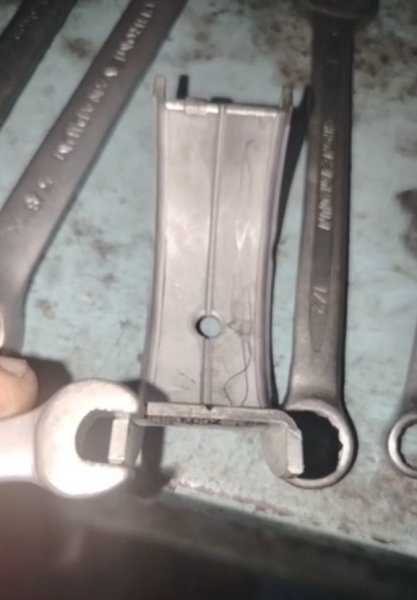

Ok, my car is 6.5K miles from my actual home and I have to take decisions based on what I remember and with the info I’m getting. It has been LOOOOONG time since I build my engine. Mains needs to be cut from standard to .010. Long time ago I got a .002 set thinking a light polish will work… but not.
This is the .002 set and my friend who is trying to help compared the thrust against a 5/16 wrench.
Is this the large thrust kind or the small thrust?
The one on pic is as far I remember Sterling brand or something like that. Have to search for the PN

However, I do have a set of 80’s vintage Clevite ms876p here.
These are the “small flange” bearings.
The OD of the flange is 3.470”.

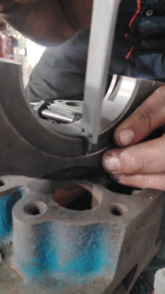

Well... cap seems to be the large kind right? Machined surface is around 13 milimeters width
