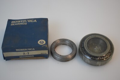

Fleabay:
A7 is the bearing package with lock ring. A7RK (Right) and A7LK (left) are the service kits with bearings, retainer/adjuster plates, lock ring, gaskets, and seals.
