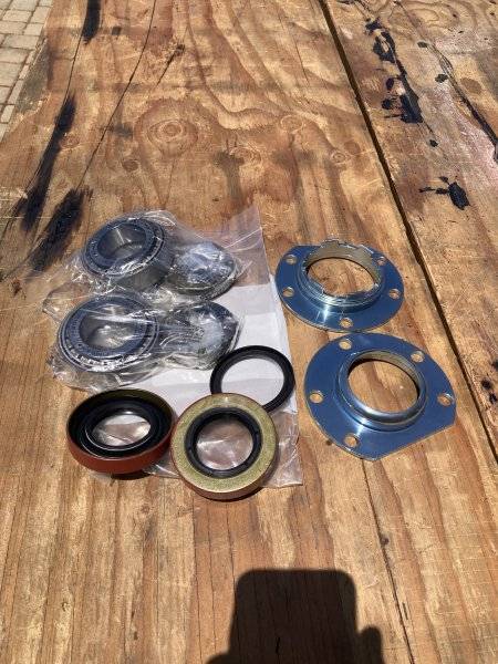

If you need the adjusters, along with the Timken bearings and seals, Yukon Gear has you covered. Just got them to undo the Greens the PO put on. The adjusters are very nicely made. Have not installed yet but soon. They have a web store on Amazon, which is where I scored mine.
Yukon Rear Axle Bearing and Seal Kit for Chrysler | AK C8.75-OEM-COMPLETE | Yukon Gear & Axle
