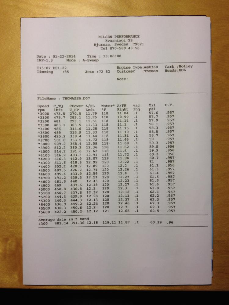

Today i was at the dyno with my Engine build
360la block ,0,60, 10,1comp
4inch stroke
Eddy rpm heads 3angle valve job and Little ported intake
eddy rpm airgap intake
750dp
comp cam XE284H
stock rockers
1,5/8 headers
450,6hp 5500rpm
516,3lbf 4100rpm
I Think the numbers are ok with that small cam, but wonder how it perform with a rollercam.
Thomas
My bet is thay will go up ! Roller is the way to go these days .

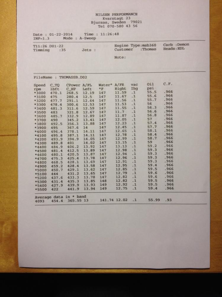

Possible to post the dyno sheet? What is the compression on this monster 410?
Here is the dyno paper
Ok that was with a Mighty demon 650 not really a big difference
Here is with holley 750dp
