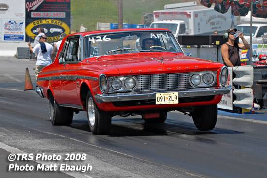

I will never sell my 63 for a newer car. In fact I will never sell my 63 at all as my kids will get it when I die. I totally agree with #1 as I love the nostalgia look of the muscle cars. And my 63 is still faster then the Challenger , Mustang and Camaro in the 1/4 mile unless they can run mid 11's. And the new cars cost about 3 times as much as I have in my 63. :yes: My 63 is not stroked and is really a mild build with factory iron 906 heads but when I do build an aluminum head stroker it will be a 10 second pump gas driver instaed of an 11 second pump gas driver that it is now. :) I went to 2 car shows this past weekend and just the :wtg: and the nice remarks I got make it so worth it to drive the car and have fun. Ron
