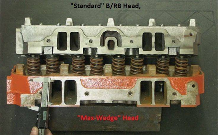

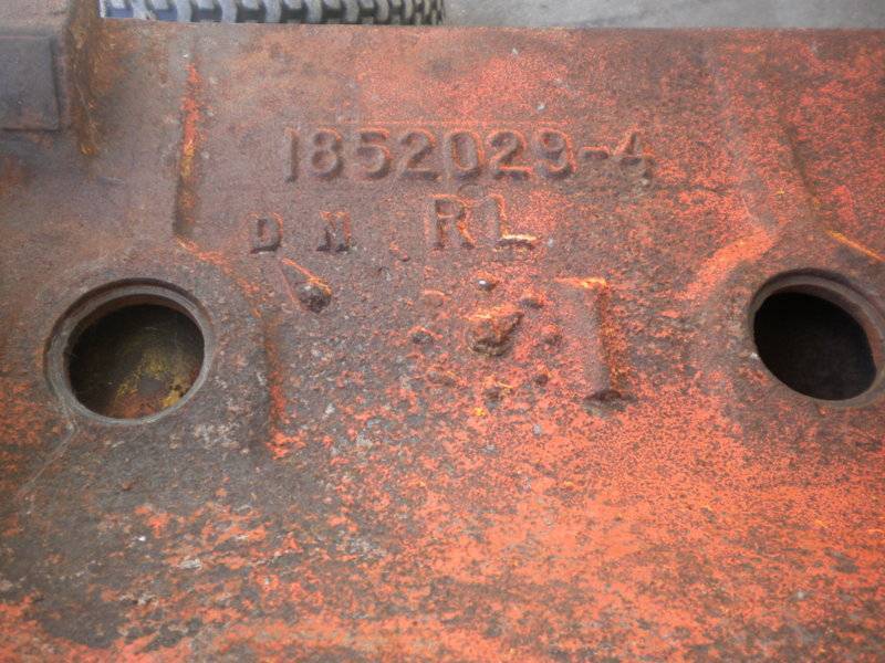

I was lucky and found one here in the UK.
It is the same block as the 1962 max wedge casting!
So I bought some 1962 maxie heads and then the money run out lol...
The ports are HUGE!!!
Just gotta save up for the pistons, crank, rods and intake manifolds now...

is the block casting number on the left side?

I could easily be wrong, I don't have easy access to the bbm that I have here, but I think the casting number is on the passenger (right) side. (Driver side in the UK, lol)
Edit: and for what it's worth, that is the casting number that I have seen posted for a 413 maxwedge. I'm curious if it has the exhaust notches.

It is my understanding that RL cast into the block stands for raised large. My 361 has LS cast into it for low small, and 383's I have seen have LL for low large. The 361 is 4.125 bore and the 383 is 4.25 bore. I thought a passenger 413 which was 4.185 bore would be an RS and a 426 which was 4.25 bore would be an RL. Maybe the max wedge 413's got the thicker cylinder wall castings?
There was an earlier thread regarding the letters cast into the early blocks called "Engine Casting # Mark Question"
