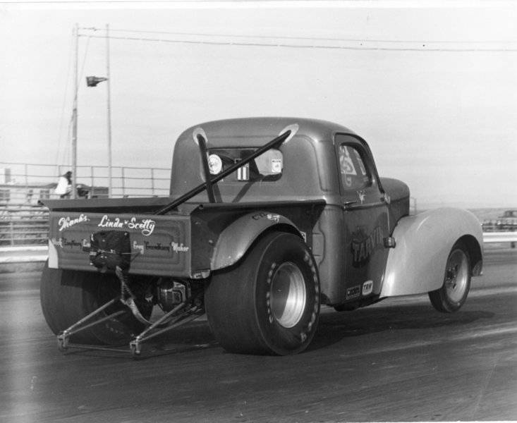

thinking back to 1974 I bought a crane RR-296 roller cam for my 426. they were called rocker arm breakers- but I never had any issues with the cam, in fact it was the best cam of the day back then. they were 296 degree's duration and .750 lift intake and exhaust.
they id require head and valve massage however to get them to live. the rockers had to be big foot with lash caps, the rockers had to be rockwell hardened to 53?? if I remember right.
the tops of the intake valves had to be cut back on a 29 degree angle from the top, and there had to be .296 distance between the valves faces when closed. the only way that could be done is smaller diameter valves(yeh right like I'm going to do that) or -sink the exhaust valves to get the clearance. I was kinda worried about sinking the valve's by grinding down the seats- but I did. this is what had to be done to keep the valves from hitting each other through their cycles. this in total took about 35 hours or maybe more- been a long time, the results were astonishing to me. the car had been laboring in low 11's sometimes high 10's. speeds only 128-130 with the previous cam, I don't recall what it was.. this was a basic 426 hemi, super rods (worst rods ever) heavy TRW 12.5 pistons, balanced, Accell ignition and hilborn injection. mostly stock -no port work and no real attempt at bluprinting the engine. the first pass with this configuration- was 9.60's on pump gas at 145. that was awesome for a mid 70's car. (41 willys pro gas) the point of this being much attention had to be in the heads or it would have killed itself instantly- worth it..
with this cam. high gear acceleration felt as strong as low gear with other cams , wonderful days drag racing..
