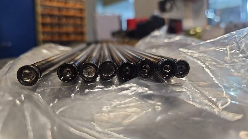

Shot adjusters and pushrods
That looks like soft metal, transferring metal, probably getting really hot
or lack of oil at the tips, too much adjuster sticking out
I've had broken adjusters before, with "allegedly" too much thread sticking out
as they claimed, but it turned out
(supposed to be only like 2-3 total threads "max" sticking out regardless of rocker style,

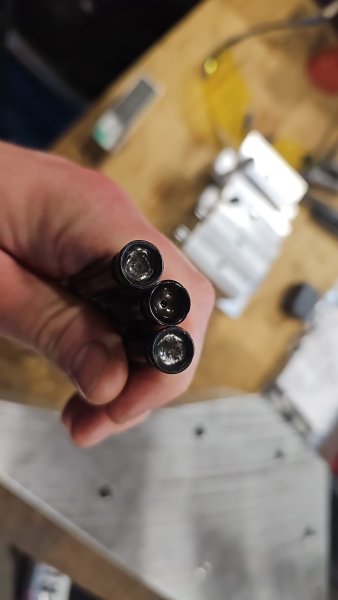

All the discoloration from the cup into the pushrod was from when they were made?? Those look to have seen some serious heat.
It´s from the pushrod to the cup, from assembly, had a too tight fit when i made the pushrods so i had to heat the pushrod and then it got heat transfered from the pushrod to the cup. They´ve been working fine with ductile iron rockers for 5 years. BUT with a solid lifter cam and softer springs. New springs are a bit stiffer... about 30%.
either way not good
Heating it (the cup tips, balls of the adusters inside) annealed the metals
'softened it', especially if you got them red hot
or near white hot (orangish looking)
& if they weren't quenched in high carbon oil after while still hot,
it ruins the temper/hardness or heat treatment
the hardness of the steel/metals, were compromised

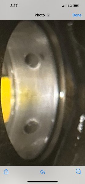

Do you not have a thrust button on the front of the cam to keep it from walking forward?

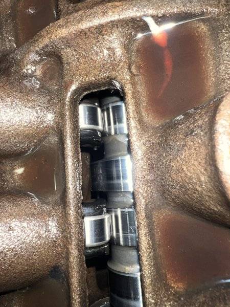

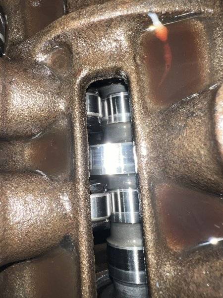

yes it’s getting oil to the heads but not enough to spray the adjusters. Yeaterday i was priming the engine again and i saw there was alot of oil coming from the cam where the passages are to the head. Then i investigated further and saw the the cam was to far out. And yes i have a cam button, but i guess it was my misstake not checking that the rollers where in the center of the lobe.
I took the timing gear off and put a comp cams magnum double roller in and the cam went 0.08 further in to the block compared to the Cloyes timing gear and now the lifter alignes with the lobes.
1st pic is with cloyes and second with comp

I’m curious about what you used for a button.
Some sit on the front of the gear, some fit in the hole but are stepped, and the step sits on the gear, others fit in the hole and are bottomed on the cam itself.

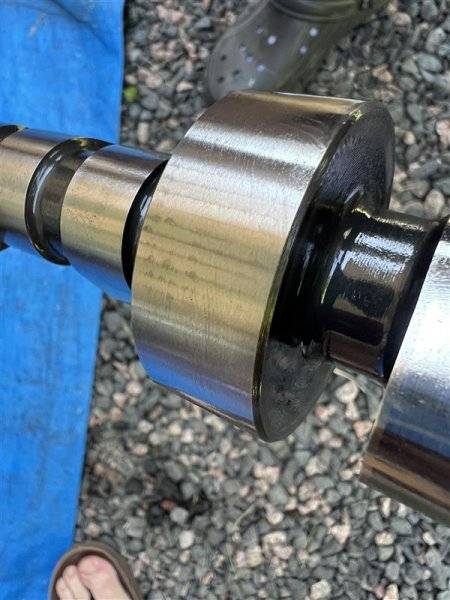

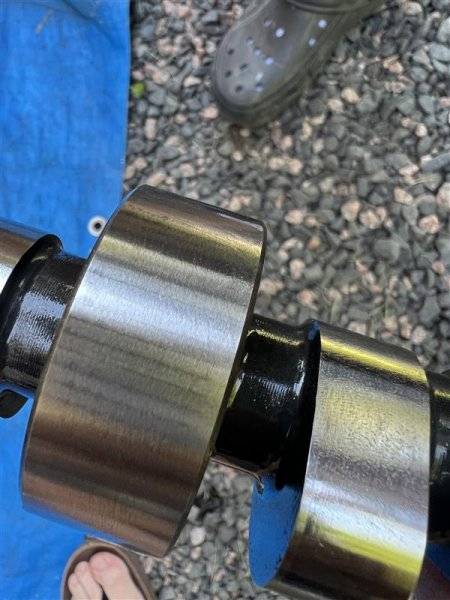

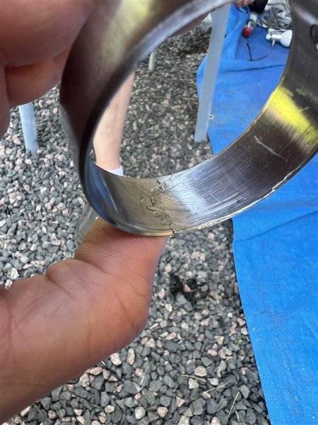

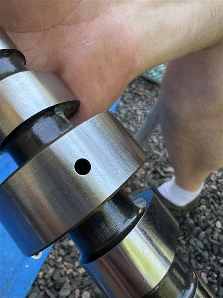

Think i found the problem.... The brand new camshaft isn´t round on journal 2 and 4 and bearing 2 and 4 is gone... So i don´t get oil to the rockers while the camshaft is spinning, but when i have it stationary i will get oil to the heads (turned so oil passages are open to one of the heads) You could feel the shatter marks with your hand and clearly see it. The camera won´t give you the perfect image sadly. These are just standard cambearings. Maybe the aren´t good enough for my springs 625lbs open pressure. I ordered a set of King HP bearings to be sure... And ofcourse polished the camshaft and had it checked for straighness

Most unlikely that the cam journals are out of round. What brand of cam brg? If you have another cam, compare the journal sizes.
These are just standard cambearings. Maybe the aren’t good enough for my springs 625lbs open pressure.
I always use performance cam bearings with a roller cam.
With HS rockers, I wouldn’t expect as much of an oil “mess” as with some other rockers, since the only hole in the rocker is at the pushrod(and whatever leaks past the bearings).

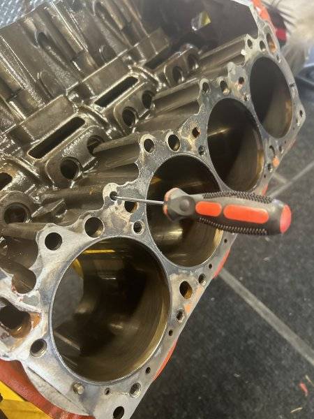

Make sure cam bearing holes line up with oil passages in block . They often don’t line up real well.
They where in spec but not round, more square like feeling when you felt it with your hand. Cambearings are or where Clevite stock bearings
My buddy just took this 528 MP hemi apart.. the oiling problem was easily identifiable :eek: View attachment 1871269View attachment 1871270
Yup that is common. I took a long brill bit and "adjusted" the holes when i built the engine. Now i´ll try to put new bearings in with engine in the car.... Will see how that goes :lol: .

I´m all new to rollercams never touched them before.. so i´m learning.. the expensive way. i ordered two sets of king HP cam bearings, So i have a set to fu** up. But i hope not, we have done this procedure before with engine in the car once before (not on my car tho)
I had that happen on a block, i had a machine shop do the bearings and the cam wouldn't go in.. i inspect it and the bearings don't line up with the oiling holes, the machinist told me i spun the cam bearings putting the cam in... really?
