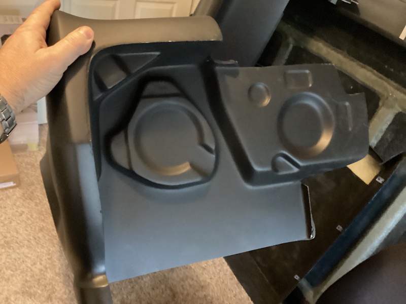

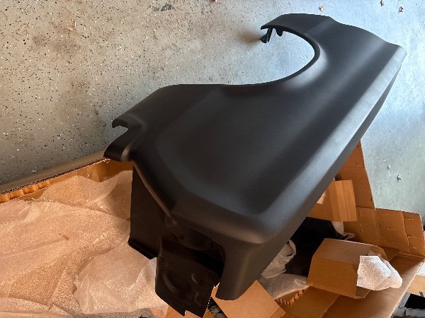

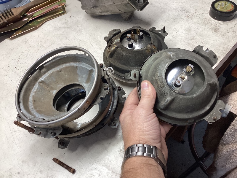

The headlight buckets are an interesting puzzle. On a 67 Plymouth, the backing plate for the headlight assemblies are integral to the fender (pic #1). Apparently Dodge didn’t attack this the same way. And although 66 Plymouth sheetmetal appears identical on the outside, this section of a 66 fender is completely different. So each year is essentially a 1 year only part. The fiberglass fenders have indentations for the headlights which need to be cut for the headlight itself (pic #2). I’ll have to figure out a way to adhere the buckets to the glass backing plate. Right now my thoughts lie along the lines of simple boltholes with a backing nut on the back side. I have already sourced a set of Plymouth headlight buckets and trim rings. In fact I have a full set of (4) plus the pair that were not damaged from my car (pic #3).

Fenders, hood, scoop, and rear bumper are from VFN. Front bumper will most likely be sourced from (edit) Larry at Sled City Fiberglass. The only one VFN had was a 66, with no marker light provisions. Hopeful Larrys item is similar to the quality of the VFN items.

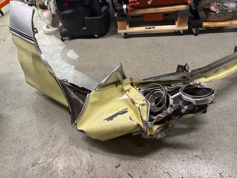

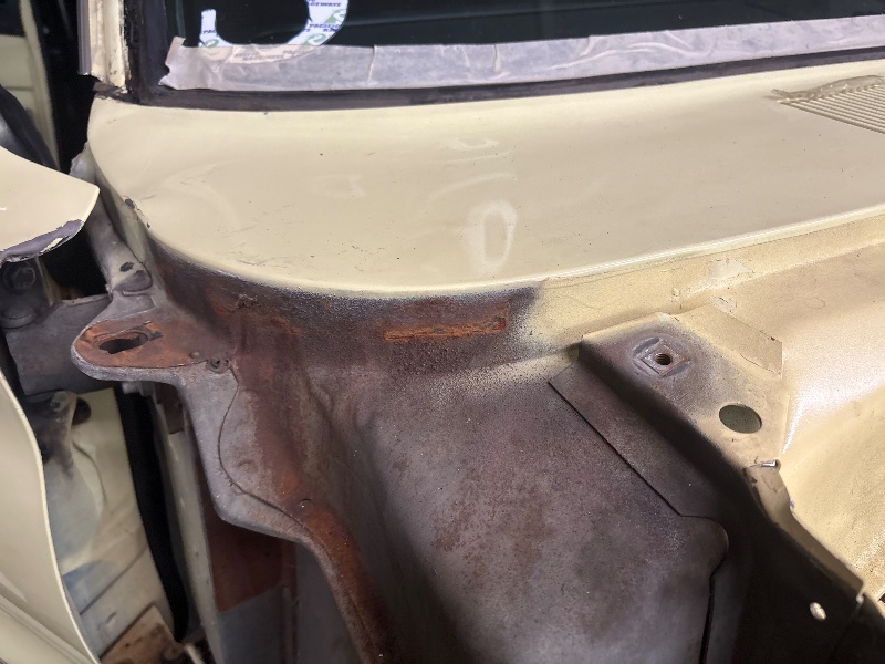

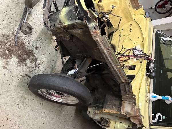

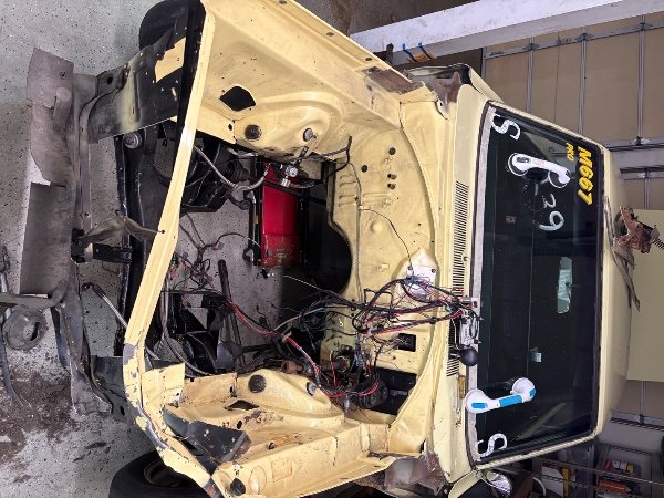

I had to nearly remove the driver side door in order to get the the mangled mess of a fender off. But slow and steady ultimately won that battle. (Pics 1 - 3)

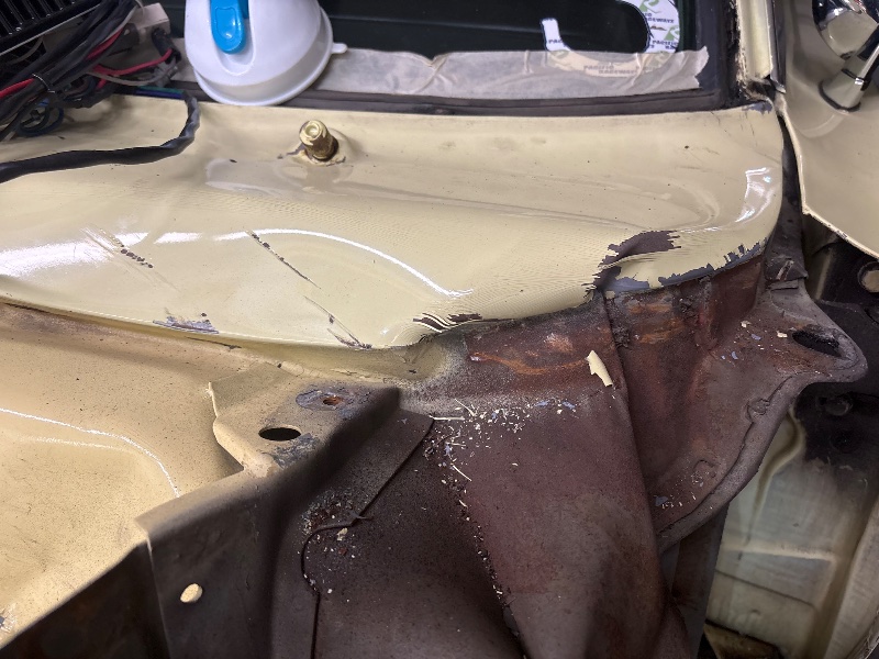

We now get a full look at the cowl sheetmetal. Real thankful this smack didn’t break the windshield. Pics 4&5 give a look at the cowl damage.

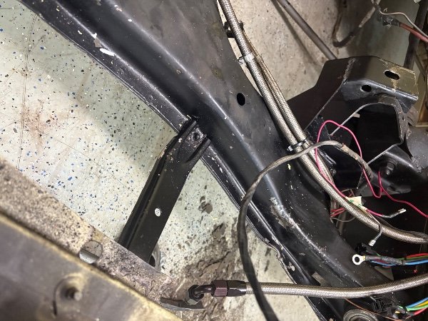

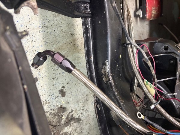

Closer inspection of the K-member show that it is indeed bent (pics 6&7) and pretty severely. Hard to see accurately in the pics, but the front driver side arm is bent upward pretty severely. With a lot of weight off the front end and the rear on stands, the car now sits with the driver side wheel off the ground. Thinking I’ll need a new K-member, so add that to the already bulging budget. Would prefer to utilize a stock unit and make modifications to shave weight and space. Anybody got a V8 K-member they need gone?

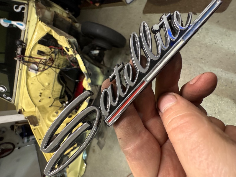

Somewhat cool that the Satellite emblem survived right at the point of impact (pic 8). Was planning on a GTX striped paint scheme with all GTX trim, including emblems. But maybe as an homage to the cars roots, we leave the Satellite emblems in place, with the X paint scheme?? I’ll have plenty of time to mull this over.
I see what may be the old wiper transmission arms still in place under the cowl. Off to the shelf space for a pound or so right there. Yes, I knew that K got K'd. You'll find another one to do some surgery on.
If you head south to my neck of the woods in the future, you can have my take out 67 K. No cost. Lower and upper control arms too.

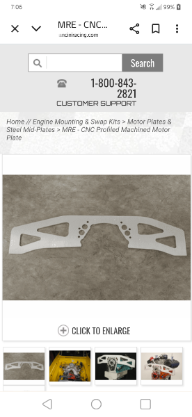

I'd put a motor plate in it. Then any K frame will work. 6 cylinder ones are cheap.
Doug
Motor plate. After all, you are now steering towards RACE CAR status unless you're trying to pass on as a relatively stock street car.
A little more expense and materials, but the chassis will work faster. Stock K motor mount brackets can then be shaved off.
I see a 67 BB k-member listed for sale about 3 hours from me for a song. Even if I had that item in my hands, would we still be recommending a motorplate? We’ve had this discussion before, Doug. But I don’t remember the pros & cons you laid out. I’m open to either, and willing to look at pros & cons to both.

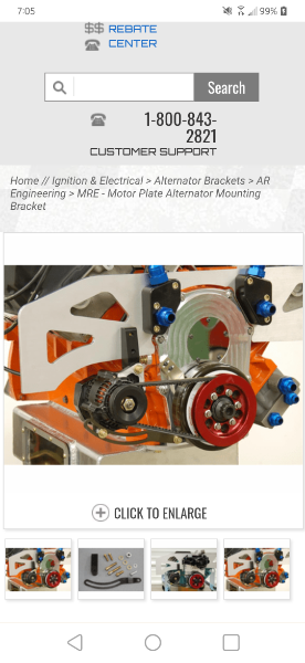

Fitting the alternator isn't to bad. If the water pump housing is milled the thickness of the plate all the pulleys will still line up. If using a plate use no gaskets. RTV only works perfect. If you want to move the motor a little for more clearance that is easy as well. Jerry Stein showed me a neat trick for pushing the firewall back. It moves like butter. Also a good time to think about enlarging the trans tunnel for more clearance. Pretty easy as well. You can call and we can discuss in detail. Remember it's now a dedicated racecar.

There are a lot of pros and cons with both. If you have the time and patience, the plate will be great. A lot of measuring, leveling and some lifting into place, so as to not lean the motor in the wrong orientation front to back, side to side.

Check mancini racing if considering plate,
My pros with plate is, more header clearance, plus no fighting with motor mount lining up and crawling under the car to put bolts in or out.

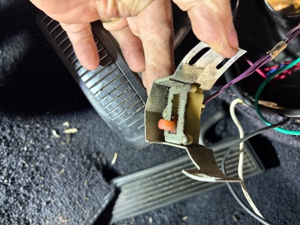

What is this switch mechanism that is screwed to the steering column?
Ive built the engine, transmission and rear end in this car. Ive done the mini-tub work and had my hands in the roll bar work. But I’ve never been this deep into a car teardown and there’s plenty of things I’ll be seeing for the first time.
Dead weight. Throw it in the ditch.
Hook it up! the reverse lights work on my racecar!
But if the switch operates on the column, I assume the only way that works is if the car retains the column shifter (???). That’s long gone here. I’ve never stood behind my car while it’s in reverse, but I am assuming they haven’t worked since I went to the B&M floor shifter decades ago. ????
I suppose I could hook up a momentary switch the to R position on the shifter?? But I’m just not sure that’s a priority for me right now.
