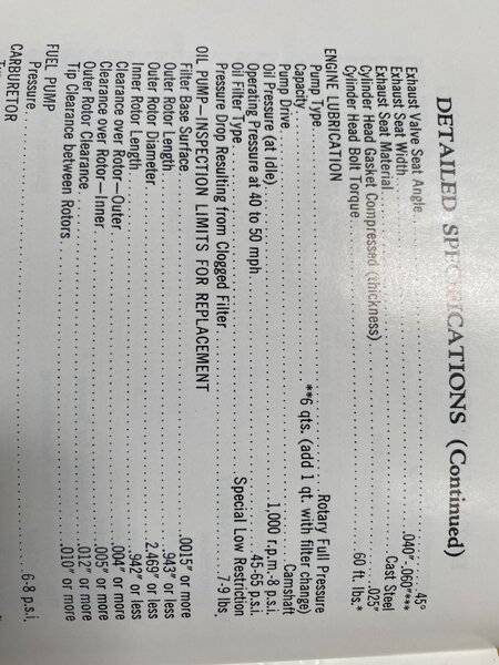

Some more info

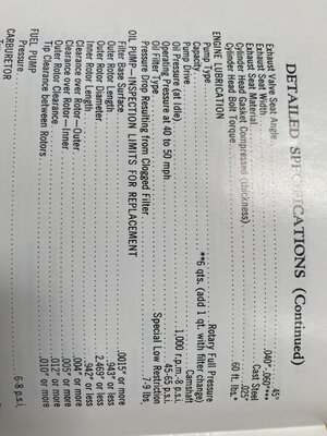

the original engine documentation confirms 8-10psi at 1k rpm idle is ok. I suspected to have not enough oil or an issue with a wrong dip stick… but it is a standard hemi pan 6qrt and 6qrt of oil came out. I checked one rod bearing and it is brand new. Need to check clearance on all
This ^ is for wedge engine. Hemi had a 75 lb spring & larger pump. Both rod & main brg clearances were larger.
Pump was not larger it had the same pump as a 383, 440. Spring is a relief spring and only would affect max pressure not idle pressure where your no were near a relief pressure. I do think that is the spec sheet for his motor vice the Service manual for OEM motor.

Some more info
I don't know where that's from, but this is a 67 service manual and they call for min 45 at 1000.
Hope it's legible

I can't find it now, but I do think that the race spec (might have been the 67 RO cars) had a lower idle rpm oil pressure. I do think 8 to 10 psi at idle was acceptable.
