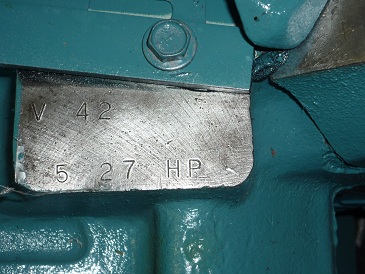

My Street Wedge Distributor Boss Number Has The V42 And An A HP? 65 Plymouth Terry's Street Wedge 5.jpg
Yes, the street wedges have HP stamped on them, too.

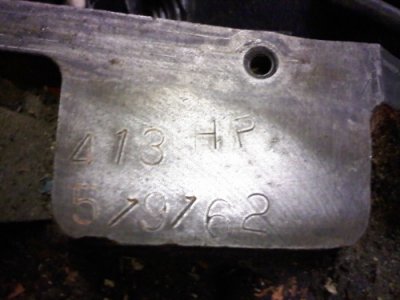

The only Max wedge engines that had HP was the 413 Max wedge with block casting #1852029
