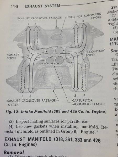

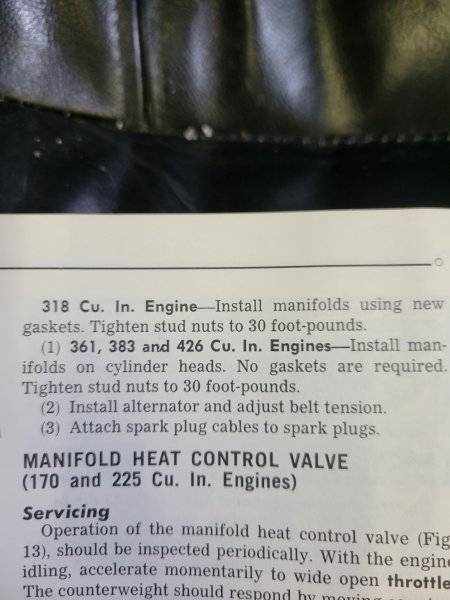

You made me go Crack open the book :rolleyes:
Found some interesting stuff though.. (and this is a dodge Dart/Coronet book, not cbody)View attachment 1411151View attachment 1411152
Portions of the Service Manuals are copied from year to year so you need to take some of the information “with a grain of salt“

No argument there. I just said it was interesting.
More interesting if this car turns out to be something.
