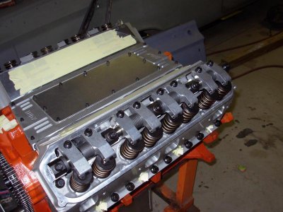

On my 68b Dart.
4.15 stroker 400 with SR heads.
.700 lift roller cam
Pulls to 7400 rpm's
T&D rockers on my EZ's also

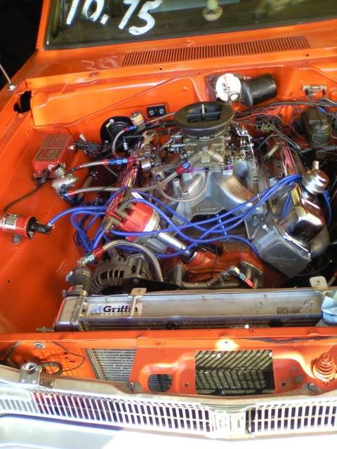

Its been in for two years now.It has ran a best of 10.77@123.8mph with a race weight@3700lbs.This year I am stepping up the converter to 4200 to 4400 rpm.This pick is after a dead beat friend didn't drain the water for me.
Not to bad for a pump gas 440.

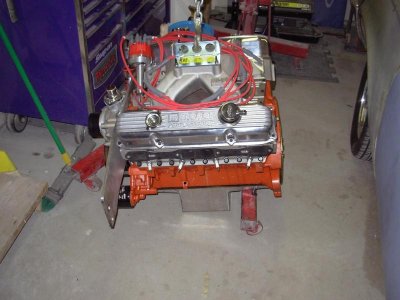

I ran a 10.71 off the juice with my pump gas 446 in my Dart.
Eldelbrock headed engine.
Excuse the wiring it's getting cleaned upo.
