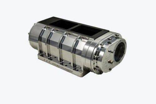

Who are the best (and your favorite) places/people making roots blowers for a 440? Doesn’t seem to be very many at all.
The Blower Shop has some nice blowers!
10-71 Blower - The Blower Shop High Helix 120 degree Billet rotors

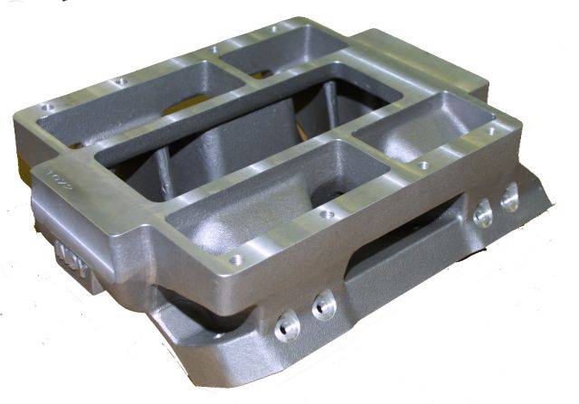

INDY Blower Manifold for 440 MoPar STD PORTS 6-71 to 14-71 Street/Competition

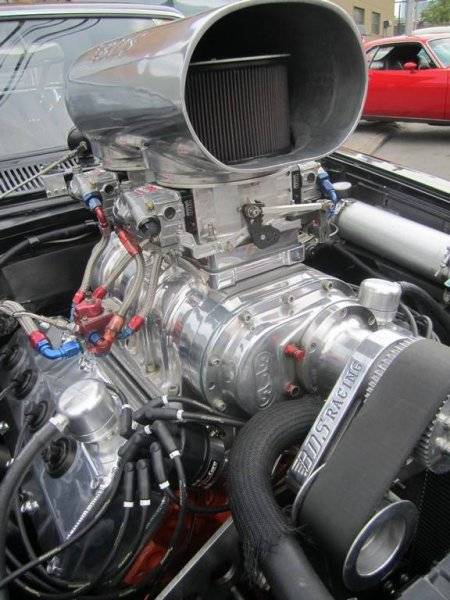

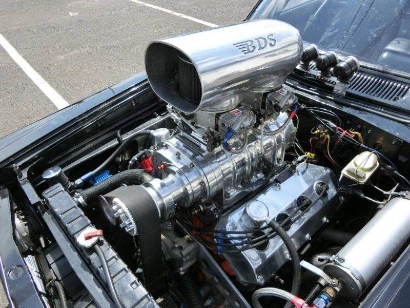

X2 on The Blower Shop. A friend has a BDS on an early Hemi, after 10 yrs they didn't want to do any customer service or updates. TBS was very helpful and offered rotors in 90* and 120* twist.
I'm running a BDS 8-71 with a TBS 4" spacer. Dealt with both companies with no problems or hassles so far. Both were very helpful with advice on motor build.

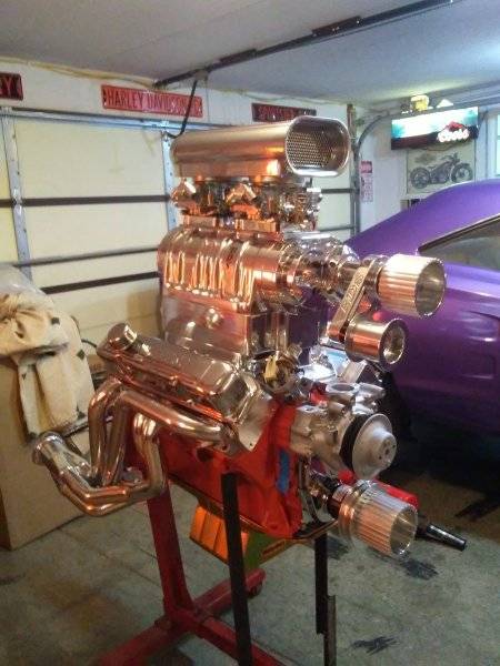

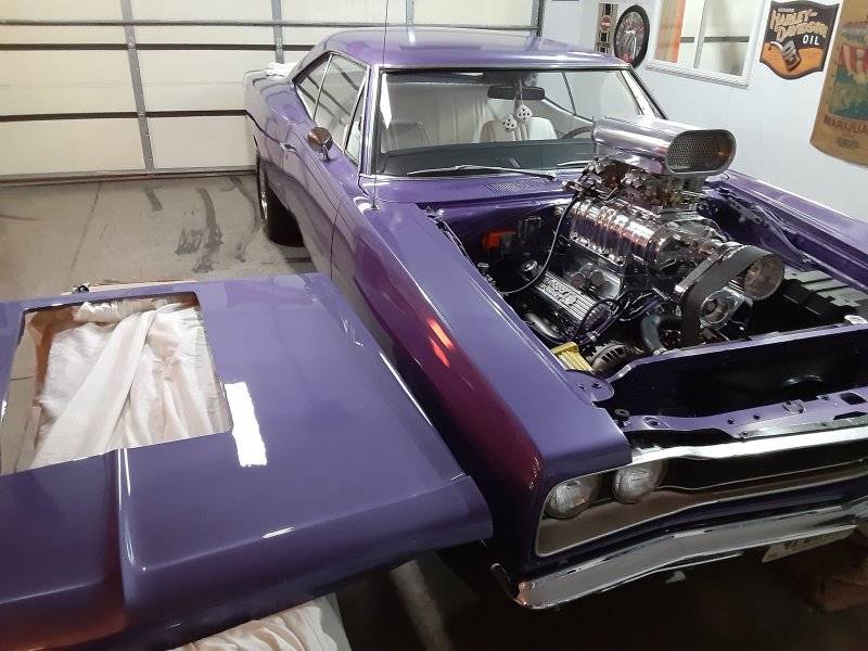

We’re using an old GM blower going to look like this one when done. But mines more of a vintage type build

(Now a few do, INDY is one)
making a blower manifold, with a pop-off valve for a RB/B engines
'not the burst plates'
(if you ever run it in the cold you will wish you had one)
