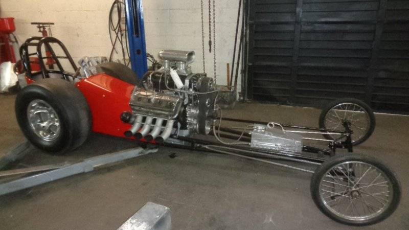

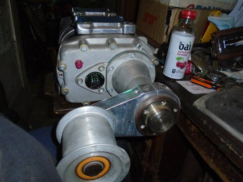

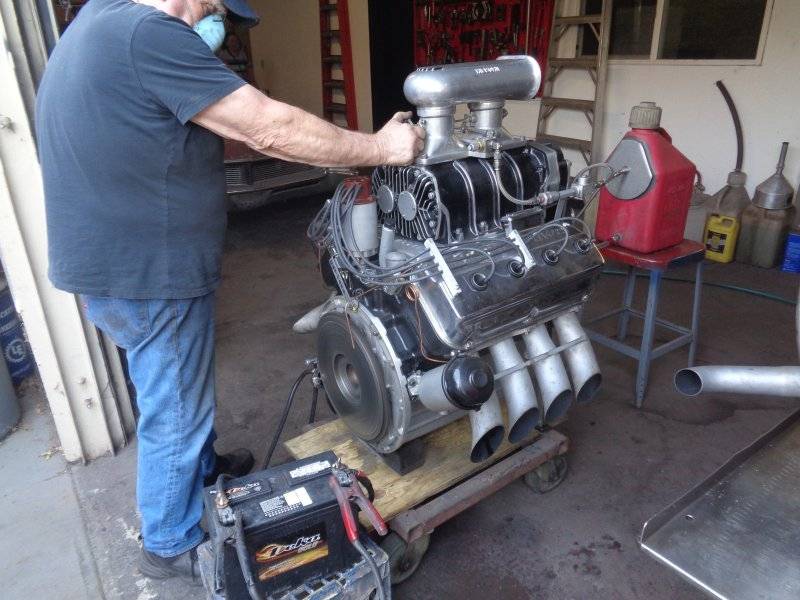

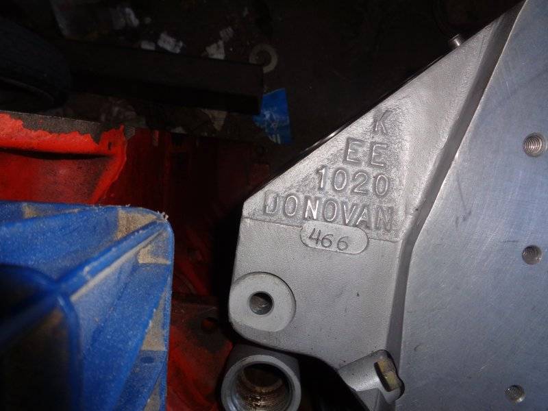

i have rudy at r & p blowers in waterloo , iowa do all my repairs , he's far less costly than bds and will fix yours rather than sell you one of their's i've had blowers than bds wouldn't fix , but rudy did and no issues what so ever . rudy's built and sold me blowers for twenty years and more than twenty blowers as well . and this donovan block is set for a 8-71 , again a rudy built blower . DSC01669.JPG
i have rudy at r & p blowers in waterloo , iowa do all my repairs , he's far less costly than bds and will fix yours rather than sell you one of their's i've had blowers than bds wouldn't fix , but rudy did and no issues what so ever . rudy's built and sold me blowers for twenty years and more than twenty blowers as well . and this donovan block is set for a 8-71 , again a rudy built blower . View attachment 1791484
I live in Waterloo and don't know if Rudy is with us and if so I think he is retired.
retired but still works the shop , he's toll me just let him know what's coming and what i want it to do , he's in his 70's now . and sold off most of his shop tools . but retained enough to build them still . he got sick , but the navy found a drug to get him back up and running . but he did get covid . and was only working part time from what i know . toolmanmike if you find time , go see the legend . rudy is a great guy !

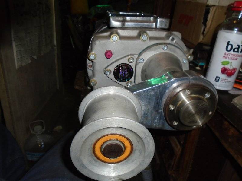

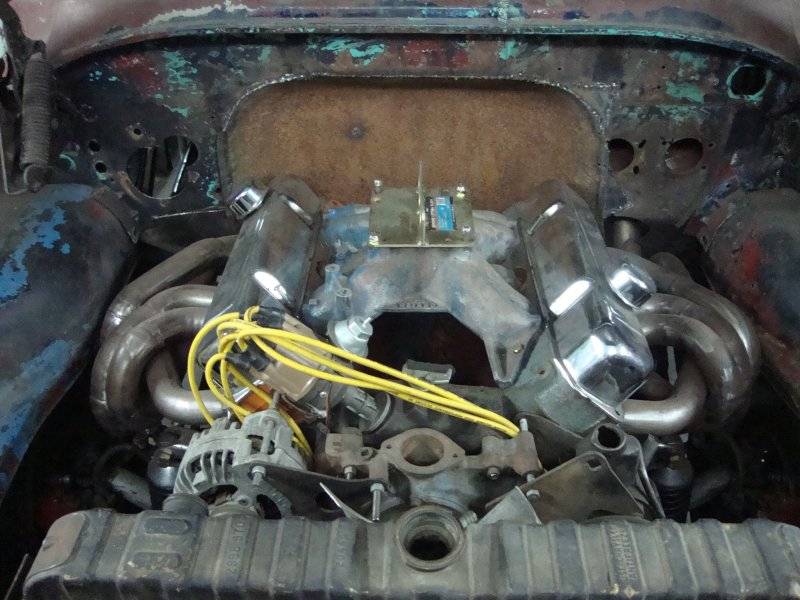

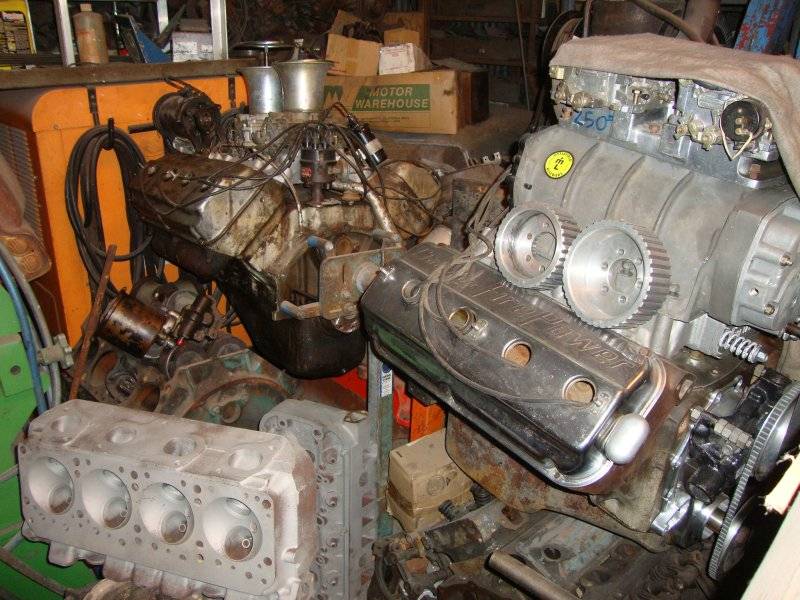

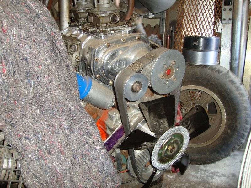

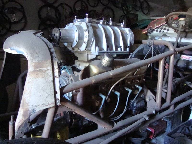

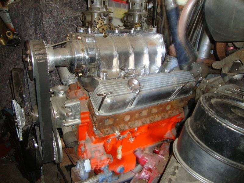

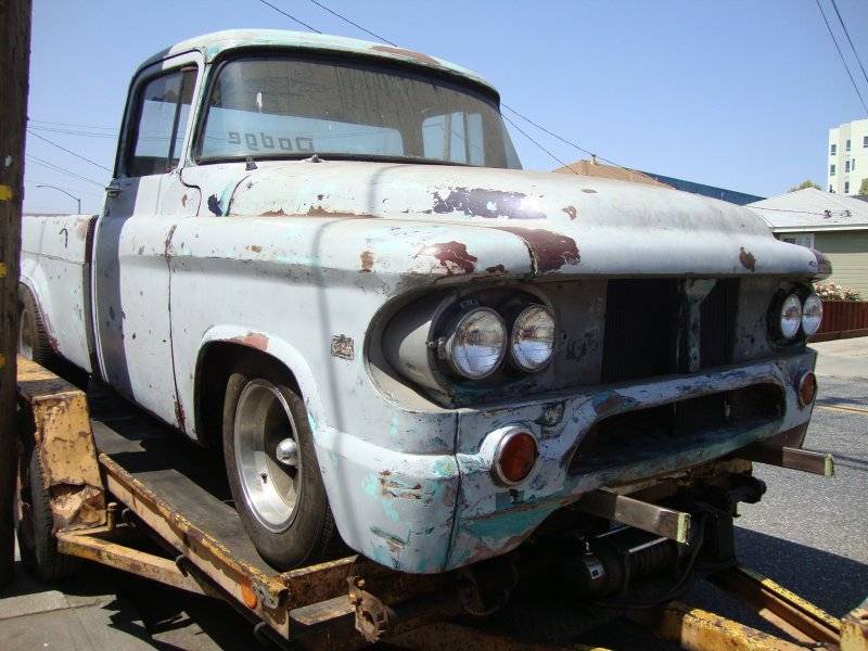

i've have dyer's parts on some packages for the street many . both of these engines are wedge headed the first is a 383 im going to try out lps fuel on , the second is for a 440 i've got stuffed in a used parts special . and that 383 is set for a 37 dodge pickup .got something about blown street trucks i guess , lol . and i have a few to pick from . my racing type drive nose are more beefer type with the drive belt tensioner not hanging on the snout of the drive . last pic is a weiand type snout with the tensioner based on the front cover , that was the racing type that stuff was way back when , i'll street it as well . but tell me who doesn't blast their street rocket every once and a while .
