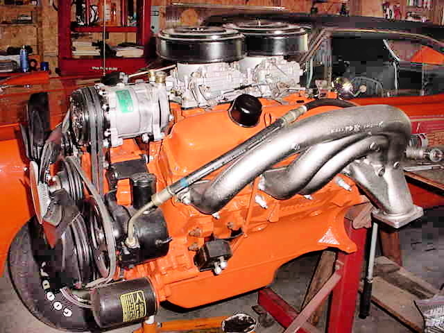

One ear was broken on this one,took one off an old block,had a friend that "knew" how to weld repair it,I would defy you to tell which ear was broken.All you need is someone who "knows" how to weld cast iron.
