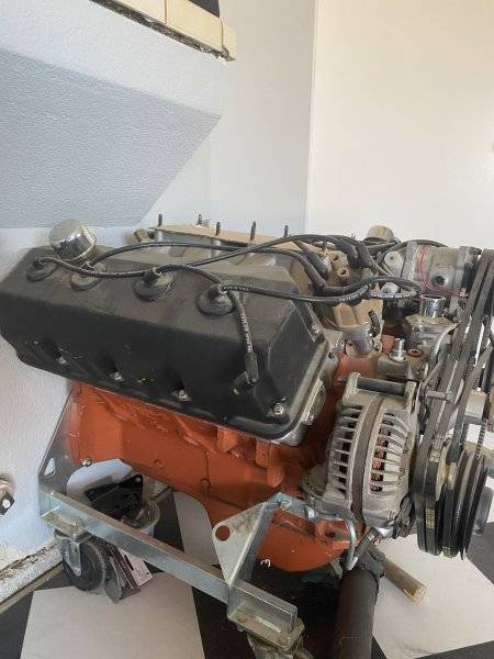

I would have said 0.055" over for 4.375" bore because there is a good selection of pistons and rings in that size, but you said it was already 0.060" over.
Only if needed and have it sonic checked to make sure it's thick enough to be safely bored .060.Any thought on practicality/feasibility of doing a 440 .060 over bore? Is it a viable option? I have a 440 block already machined to .060 over bore and was wondering if the block can hold up under normal driving conditions, not "Racing". Essentially a "good street motor". Using cast Sealed Power pistons.
Like this...but I have in my possession:I'll throw out there that if someone is reading this in the future.. go .055 over first. Then you're using the common 4.375 ring package, and leaving yourself room to go 60 in the future..
