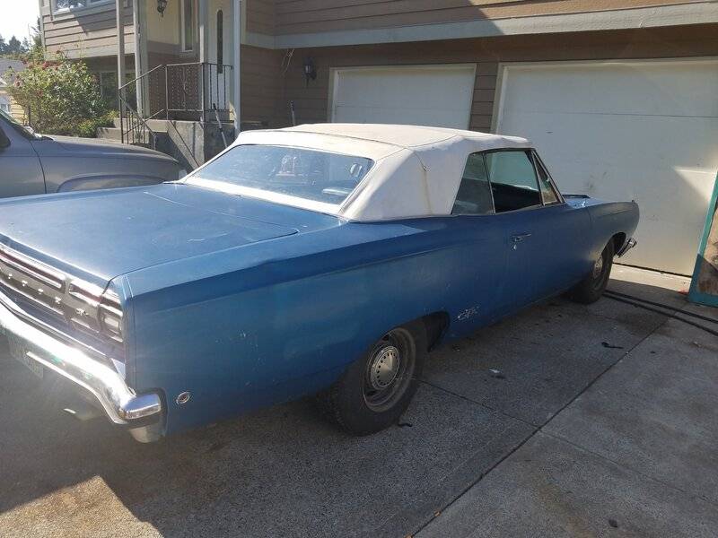

Looking for recommendation's on the cam I should use for my restoration. I want something close to stock for the 68' HP, good low end power, and maybe just a tad bit raspier sounding. There will be no racing involved (At least not serious) as the car's too rare to screw up. Then there's the question of quality- Only want to do this once. Thanks in advance
Beautiful car! I see it has the rare for ‘68 rubber bumper guards. You rarely see them.
