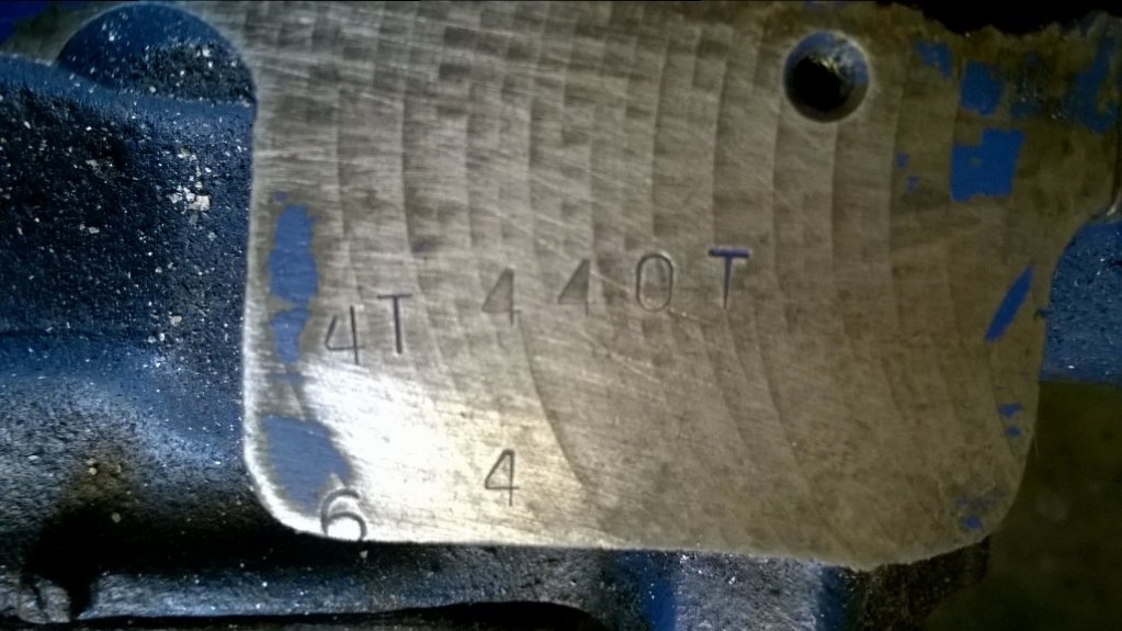

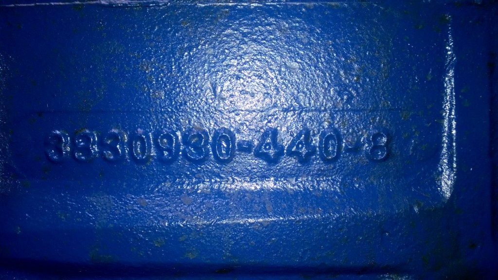

Ok...lol...I have been out learning stuff since earlier. Turns out this engine is an "RB" block, cast crank, "902" heads,8.9:1 compression,
4.32 bore/ 3.75 stroke, built in Trenton 6/4/1974. From what I have gathered so far, the open chambered "902" heads flow as good or better than the "906" heads. This motor has the raised rib along the sides of the block just above the freeze plugs, thicker ears, 10% more cast iron in the block, good thick cylinder walls so I can bore it .60 over if I like, raised deck, increased sized cooling passages, and is classed as a truck engine. The scoop says the cast crank is fine up to 600HP as are the pistons and the block. So I guess my path forward will be to have the block and bare heads hot tanked, sonic checked, honed/bored .30 over, parallel decked, and hardened seats installed on the exhaust side. A 30 degree angle cut on the valves is also a good bet. Porting and smoothing, Gold Race rockers, new springs, small cam, 850 Demon, M1 intake, 2" carb spacer, high volume oil pump, 3/8 fuel line, new rings, performance gasket set, performance ignition. With those things installed it should put out 502 LB-FT @ 3700RPM, 512 LB-FT @ 4900RPM and 519 HP@ 5400 RPM. or thereabouts..lol.

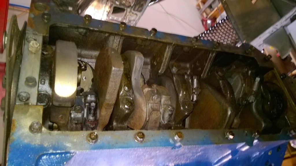

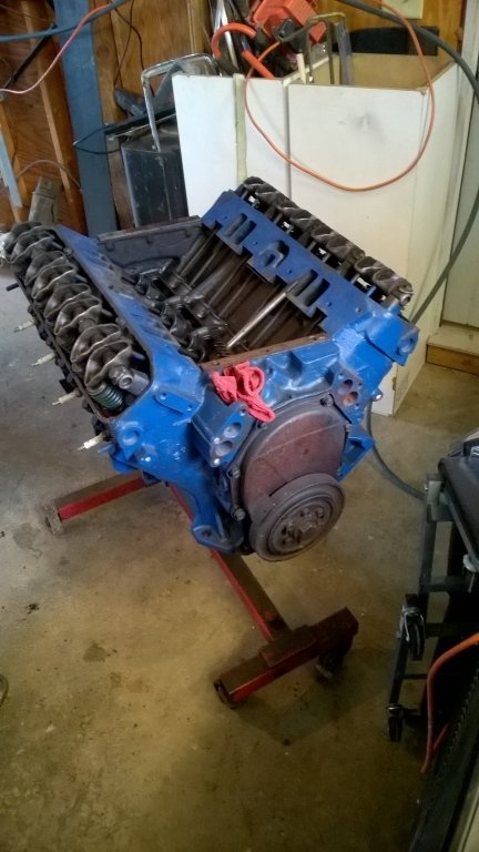

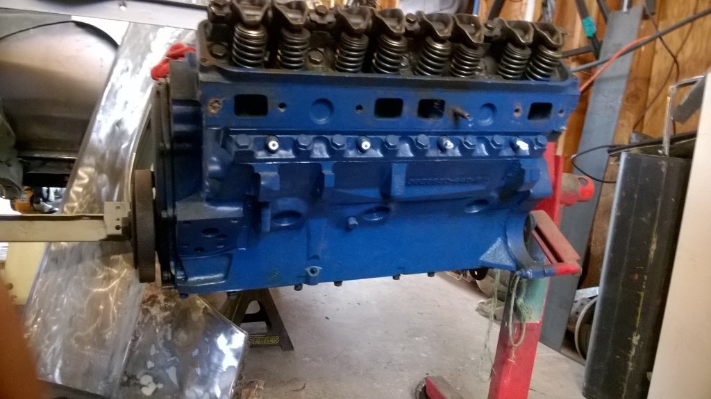

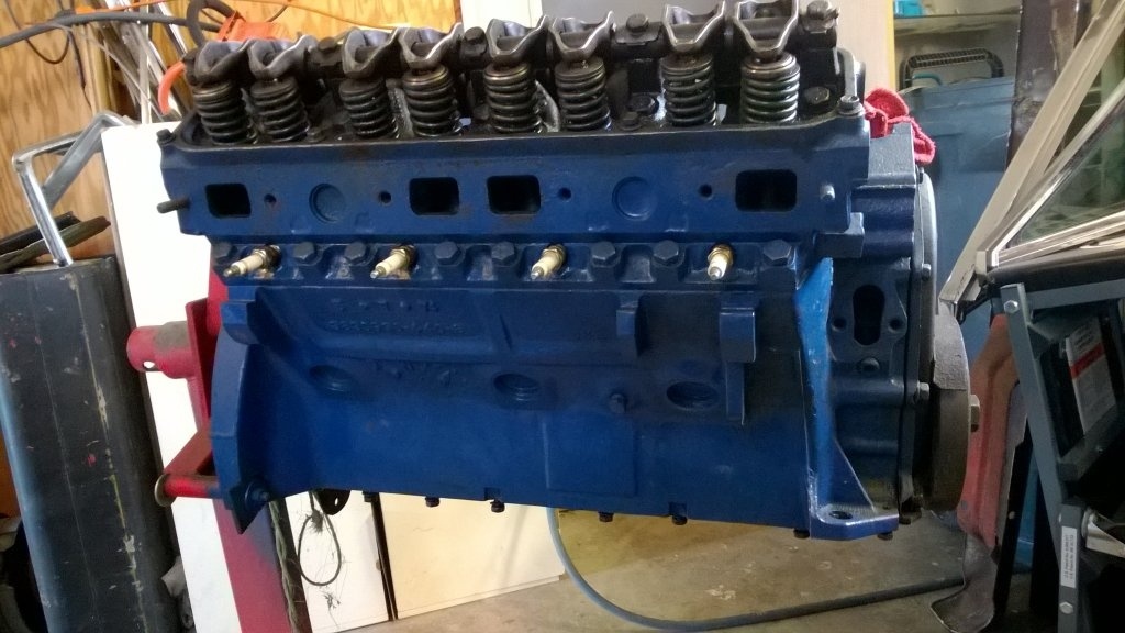

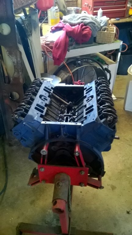

It's a completely stock motor. Here's some pictures, I just got back with it. Cylinder heads are # 3769902-8, block is # 3830930 made 5/7/74

You are better off without the crank and heads for that motor. If the block is standard bore that is a great deal......

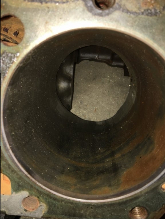

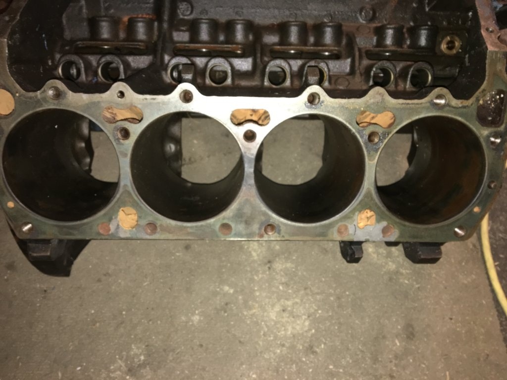

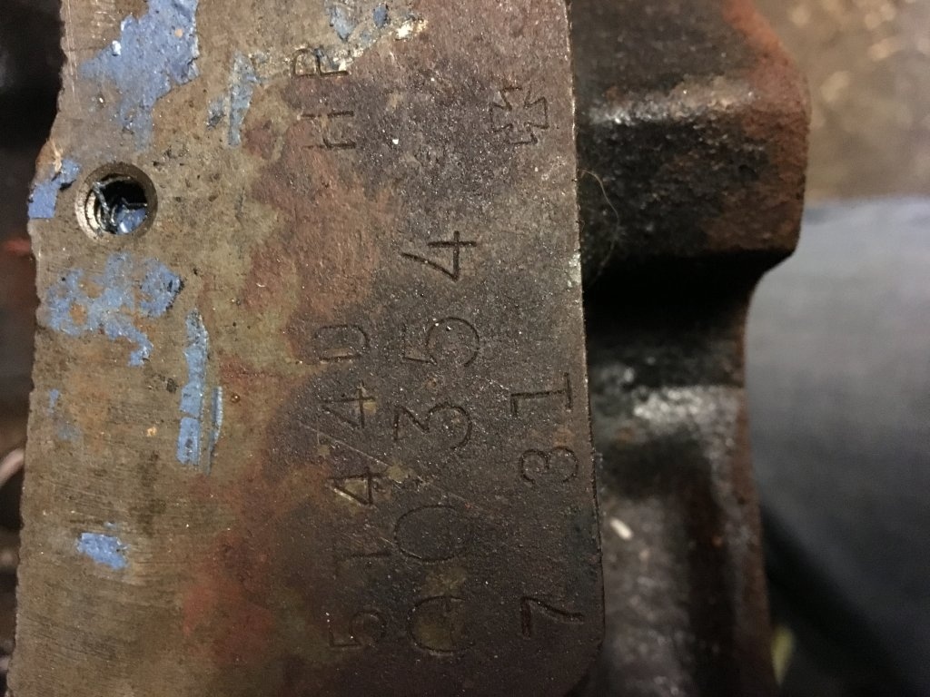

Ok got the block, looks good for sitting for 8 years! And the guy had a 70 road runner sitting in the garage!! But got the 440 and 727 for 200 bucks, block is stamped "HP" on the ID plate. Can someone help me decode this. Thanks

The block is a 75 Truck 440, HP for cam/springs/4bbl carb, July 31 build date, and the Maltese cross dictates a factory oversize. I would have to consult my service manuals tomorrow to tell which part. The 00354 is a job stamp from a previous shop. It was bad judgment in my opinion to stamp it there... The bores are not fresh, and I would hone them to 0.040 over. Do not bore and hone, just hone. I would also recommend to have the block cleaned, mains align honed, decks squared, bored, then honed, in this order. Each process builds on the one performed before it for a correct job.

Ya I think it was a pretty good deal, wasn't expecting him to still have it since the listing was 8 months old. The Maltese cross on the id pad would that mean an oversize in the cylinders, or on the crank? Never seen that before
Looks great, nice score! Does it have the raised bands along the sides just above the freeze plugs?
