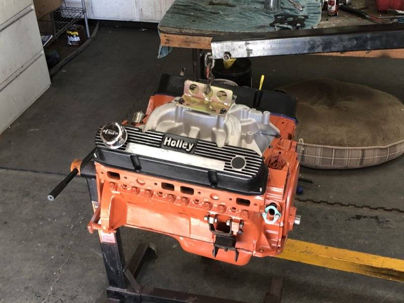

I have a rebuilt 383 in a car with maybe 200 miles on the rebuild. It runs great but isn't all that fast.
It is probably a silly question but can a 440 crank actually be swapped into this 383 block without changing pistons?

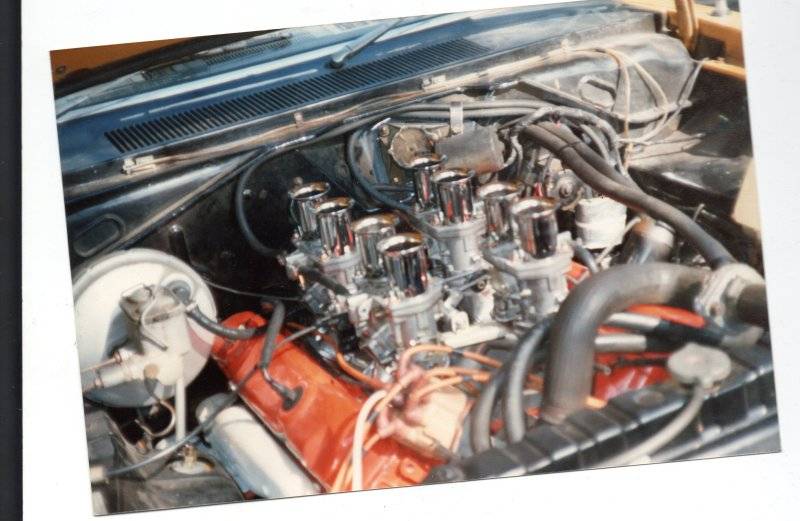

I did this back in the 80s. 438 cubes I used the 383 rods [ R/S ratio is not as favourable with 440 rods ]; had 1/10" machined of crank counterweights.
This was before 'kits' were available so I used 454 Chev pistons & 906 heads. It went very well...
This is the engine Weber carbs on it

I'm not that anxious to pull the mill with so few miles on it.
The only thing that was appealing here was the chance to do it low buck. Adding the cost of a set of pistons and rings makes it less so.
