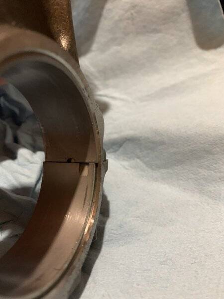

Adding a picture to this thread to show what it looks like when tabs are wrong, cap installed backwards. Hopefully you can see the bearing shell and cap are now shifted over the wrong way. That would cause very bad interference on a stock undercut crankshaft journal and very rapid failure on an aftermarket crank with radius journals from extremely bad interference.
OK, then I must have them in correctly as mine are not as your picture shows. Many thanks for your effort.
