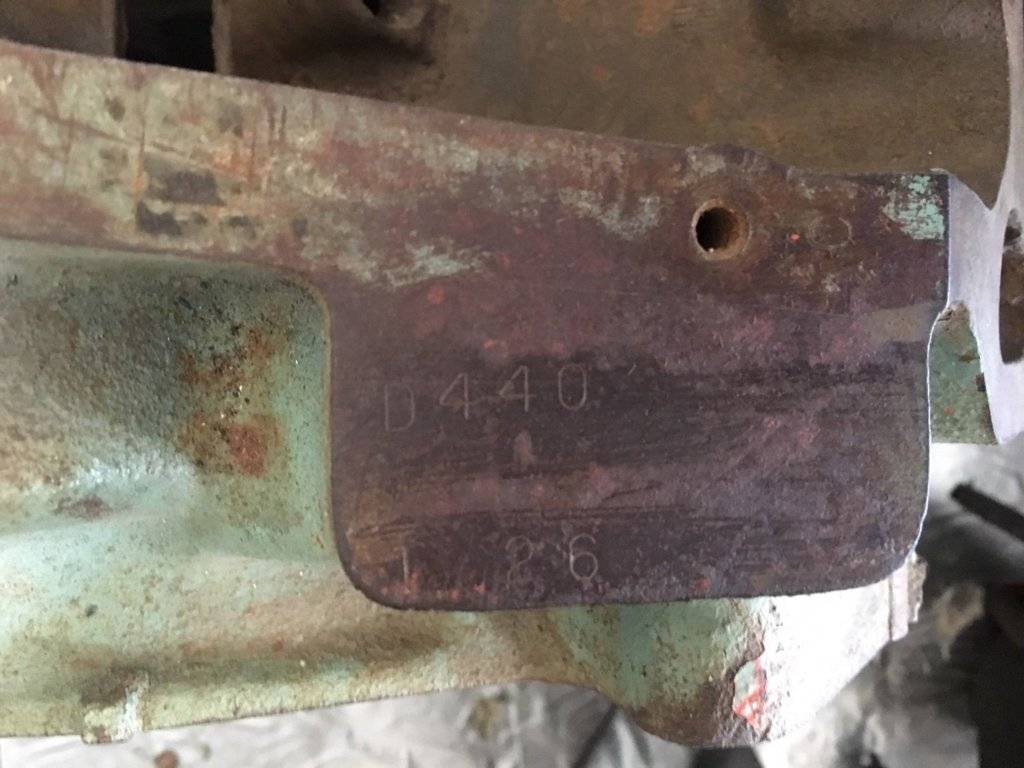

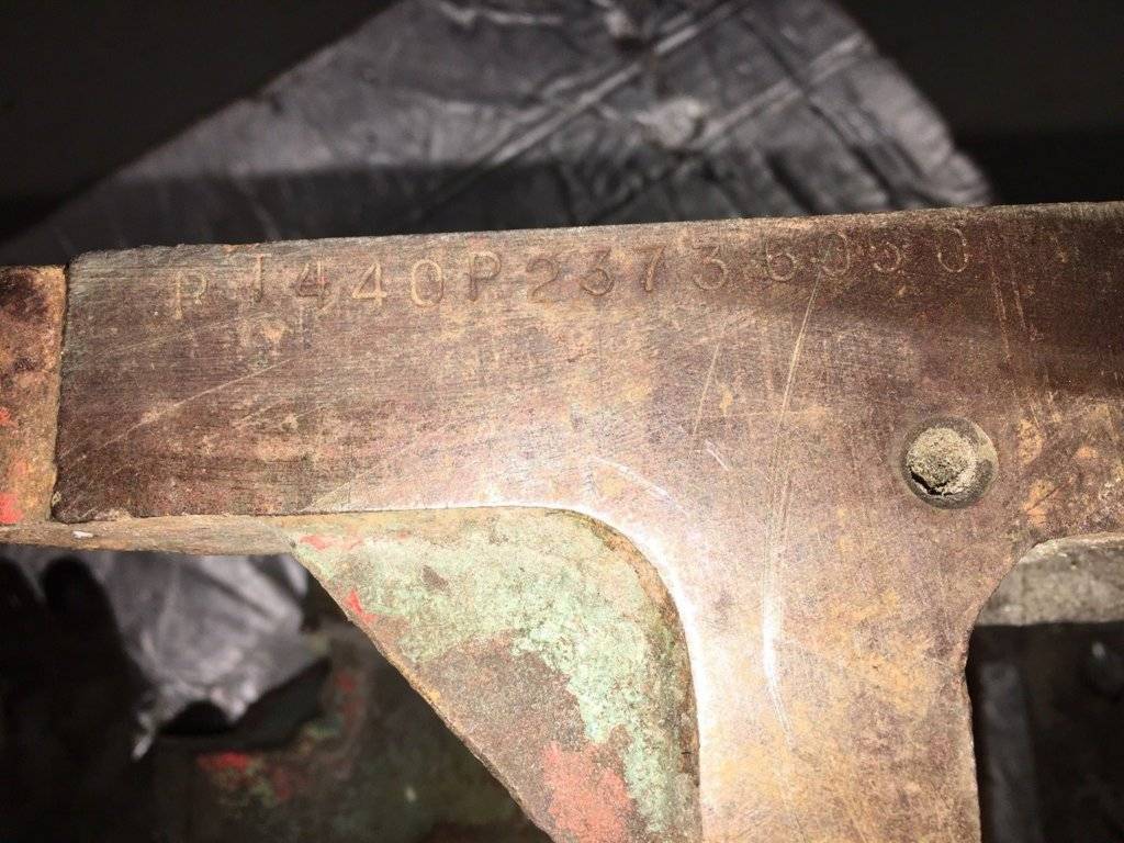

Hi All,
Just joined, I’m from England.
Looking for some info on a couple of 440 engines.
Over here they are very rare to come across,
Been offered a 1968 440 block.
But I cannot identify it, owner claims it came from a 68 charger.
Engine casting number is right.
The engine block serial number is PT440P23736050,
PT points to coming from the right plant, Trenton
The P after the 440 I didn’t think the engine should have a letter there?
Have been told if it had an S in the engine number means Hi performance?
but a P perhaps Police??
Front pad is D440 =68, date code looks right.
But top of picture by drilling looks like a C, could be LC (low compression) was told a wrong way round C could indicate 6 pack block but no HP stamp on pad?
The owner is a few hundred miles away so not easy to pop over to look at, and he is not a car man.
Was it only the RT 440 stamped HP and the standard charger 440 not stamped HP?
I Have a 68 RT charger, it was a one owner from Texas.
It Came to England back in the late 80s.
My Charger had an block swap before it came here, it’s got a 1970 440 in it non HP. Carb heads etc correct 68
so was looking at this block as it’s a 68.
Just trying to decide if it’s worth getting and maybe swapping in the future as unlikely to see one over here again. Or just keep my 1970 block?
It’s hard to decode you read one thing on the net then something contradicts it and your back at square one.
Few books I have don’t really break it down enough.
And as you can appreciate these cars and blocks are rare to find over this side of the pond.
Any help, ideas would be great
Thanks all

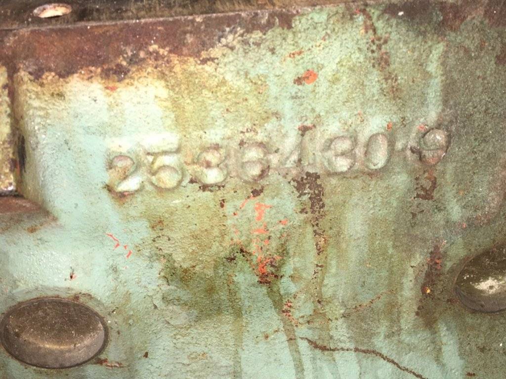

2536430 simply is 66-72 440 engine
PT is trenton plant
I believe the rest is a sequence number?
Can’t really make out the “c” in the picture but that could be a stamp from a machine shop.
Im sure someone else will chime in that might be able to verify

P = premium fuel
C = unknown but often erroneously reported as "6 pack block". There is no such thing. A block is a block is a block.
No HP stamp on pad = from a C body; not an R/T or GTX.
Ask the seller if there is a VIN on the back of the block near the oil sending unit.
PT440P23736050
First - Welcome!
PT - plant
440
P - premium fuel (I'm pretty sure but not 100% without looking it up)
2373 - 1/26/1968
6050 - sequence of engines built
Date is good from oil pan rail to stamp. My non-expert opinion is this is legit. This should also have a partial VIN on the top rear by oil sending port.
The C up on the rail isn't anything but something the assembler did. No value to the 'numbers' of the engine.

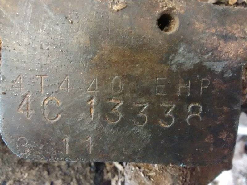

Hi
Another UK member with the same question. I have tried searching on the web, but the numbers on my block seem a bit different?
They are:
4T440 EHP
4C 13338
3 11
From what I have found so far the "440" is the size (which it is), "E" is a cast crank (which it has), and I think the "3 11" is March 3rd. Do they sound right?
What I don't know is what the "HP" stands for (High Power?). If it is a High Power, what does that mean, or what is the difference?
What does the "4C" mean? Is it the plant code?
I think the 13338 may be a year code, but I can't work it out?
If it's any help, it has the large "Figure of 8" cooling passages from the block to the heads.
Thanks for your help!

don't know if it is too late but just got here.....after all these years...
4T440 EHP.....means: 1974- Trenton plant- 440ci- cast crank- High Performance
4C13338 means: 1974- Jefferson St. assy plant - #13,338 engine
3 11 means: it was made on Mar 11
