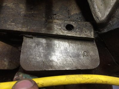

I can't seem to find a solid answer on this ID stamp.
8T 440 F HP
3 10 2
15 on the end
Is this a 1968 HP 440?
Or is this a 1978 (8T according to some internet info) which would not be a HP?

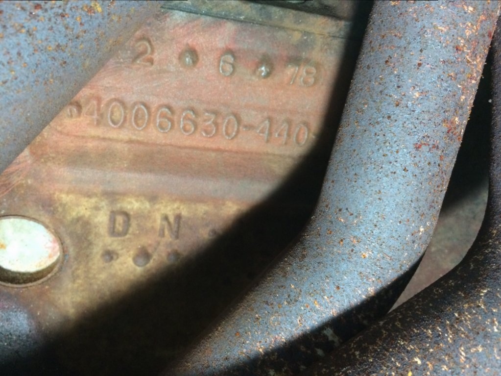

What is the casting date on the side of the block?
Which side and where would I find that?
I believe drivers side. Should be a date cast in the block with a casting number under it.

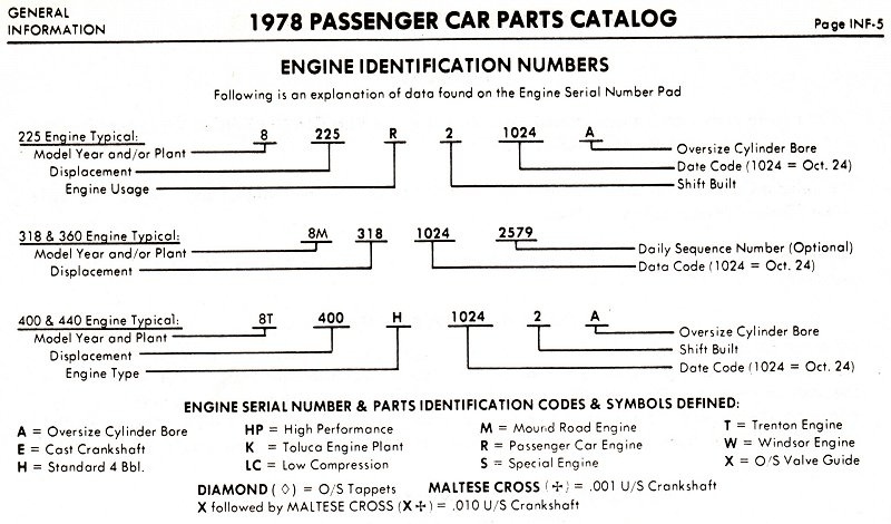

8T is 1978
HP is the high performance. Trying to figure out the "F" in front of it.
Look for stamped numbers on the lower pan rail.
This may help. I think you are probably seeing an "E" not an "F". What is the VIN number on the passenger's side of the block?
Found it. Looks like June 1978. What Hi Perf anything was in 78??
