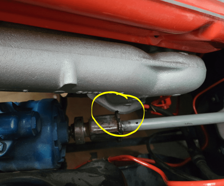

Hey all,
I am finishing up my 1966 Charger. I swapped out the original 318 for a 440. I have standard exhaust installed and I the column knuckle to the steering gearbox is just touching... clips the exhaust as the wheel turns.
Is there a problem with the steering joint or do I need to change the column connector knuckle???

But I'd be worried about the seal on the coupler as it's going to get pretty hot that close.

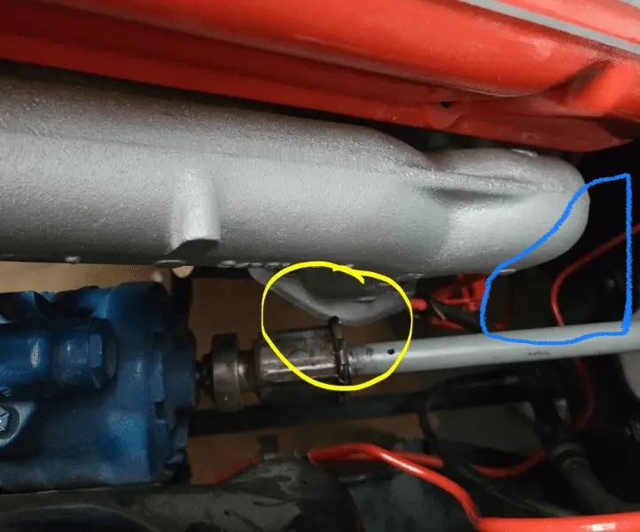

That is a C body manifold. Chrysler never put one of those on a B body because they interfere with the column.
b body std and HP manifolds dump in the rear area circled in blue, see all the room there? That’s what it’s for.
AH... That's my problem then. It is a 1966 Charger. I have hauled this car around since I was 16 and when I finally could afford to rebuild it, I moved from the 318 to a 440... 67 block. So I need to find a exhaust for a 440 b-body :(
Easy. Any big block b body , 66-70 .
You can you get a coupler from Flaming River or Borgenson.
That would definitely be the answer. I will look for one.
That's the answer thank you.
Did you have exhaust pipes made yet? If not get a pair of B-body HP manifolds.
