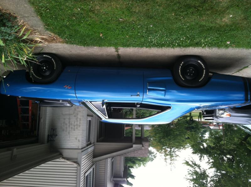

The car is upsdie down....all the oil drained out.... (Sorry...could not resist)

Too funny ....
X2
