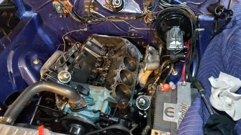

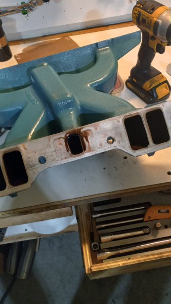

I started the tear down. First thing see is I'm pretty sure I was sucking some oil in from valley pan gasket. Oil on threads of the spark plugs help support the idea .

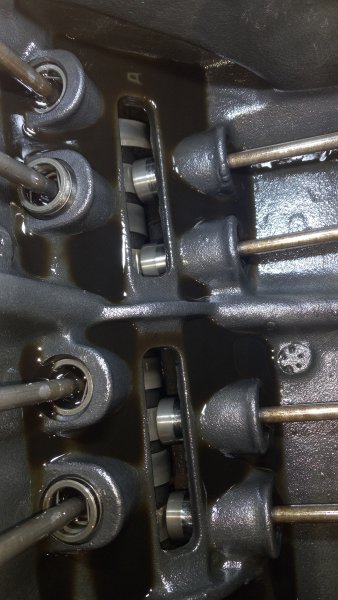

Intake a valley pan removed . Cam looks ok I think from compared to other post pictures. I tried turning the push rods.. there are 6 that I can't spin , is that becuase of their position on the cam lobes ? .

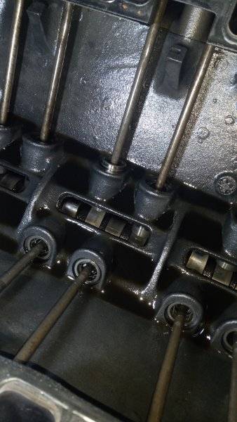

Lifter preload is automatic with stock rockers. Be sure when you take the lifters out that you store them in a manner so that they can be put back on the same cam lobe for the next time you use the cam. You really need a lifter box and mark which way is "front".
grab the pushrods to see if any are loose. If you can take excellent photos of the cam lobes, you will get good opinions. I don't see any black that's always a good sign

Push rods that are loaded won’t spin. You don’t mention what rockers you have, stock or adjustable.

Looking at those pictures you definitely where sucking oil over the years into your intake runners and ports - That would form carbon or buildup on top of your pistons

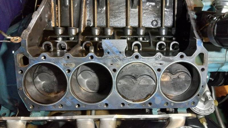

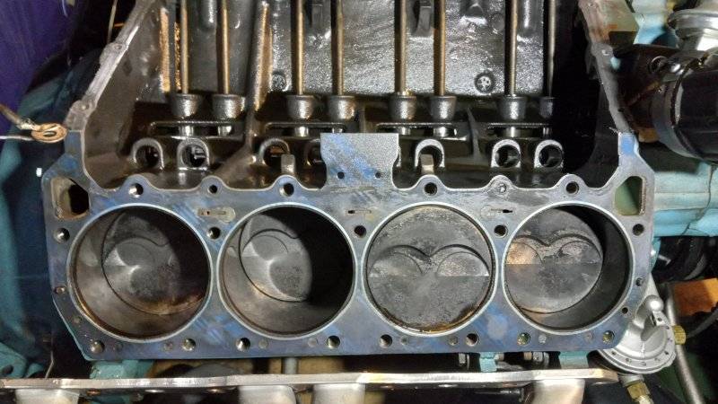

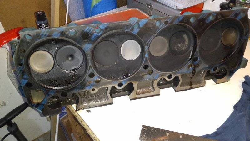

Made some more progress tonight. Got the passenger side head pulled off.

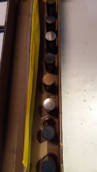

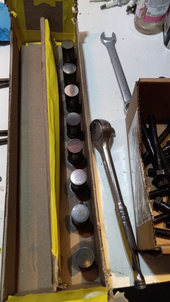

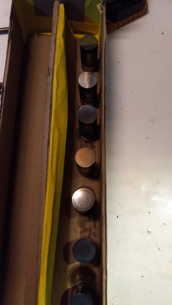

Have included some pictures of the lifters they all look identical.
When I was breaking the head bolts loose, they sure didn't feel like 70 ftlbs I was surprised at how easy they seemed to break loose .
When I went and broke the head free from the block quickly found out I did not have all the coolant out! ( I clued in that I drained the coolant when the car was jacked up and I was unbolting headed from the exhaust, must have left coolant at the back of the block ! ) so there will be some things that look a bit wet in the photos .

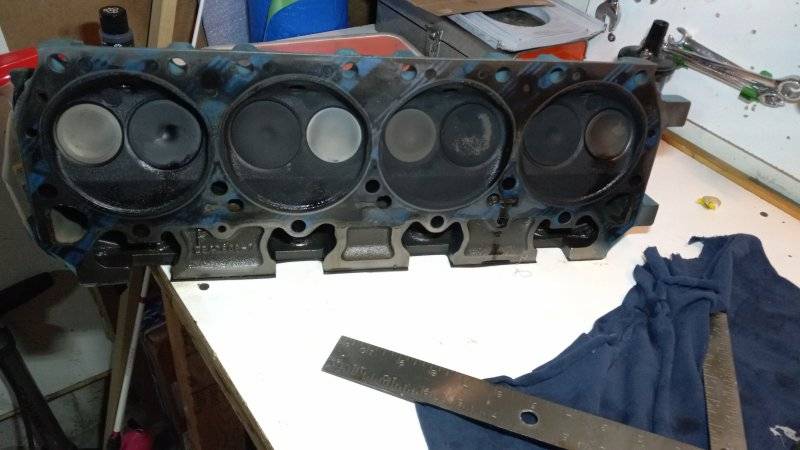

On the heads you can see how white the exhaust valves are on the two cylinder that were reading low. What do u think that means ?
I also spotted some very small soot marks around above 2 of the exhaust ports which mean there was a small leak.
Yeah it looks like the gasket surface is blackened and blowing by-- supports the lack of torque theory

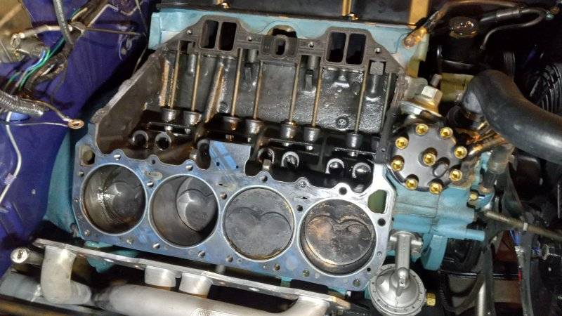

I was able to get the other cylinder head off tonight . Geez the passenger side is a PITA ! I was able to get it off with the header still in the car but feel I might have to pull it out when I put the head back on so I can actually TQ things down properly! Only one picture from tonight was beat ! Haha
Yes, likely.
