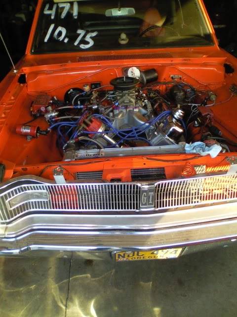

Here's a pic of my 440 with RPM's.
It's a street legal,pump gas,10 sec dart.
It doe's 10's off the juice.
Launching at 2000 rpm's
