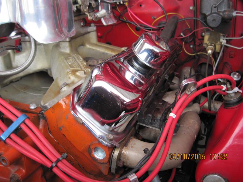

IMG_2634.jpgMy 65 coronet with a 68 440 block needs new headers. Currently has the old 2 piece Doug's headers and #6 is cracked just a few inches from the exhaust port (previous owner strapped a soda pop can around it but it is now leaking) so I thought maybe I should just replace the whole set.
Don't want to buy a set that will need to be modified, just want one that fits. Any recommendations?

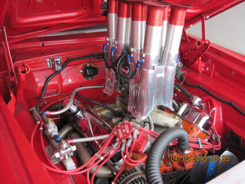

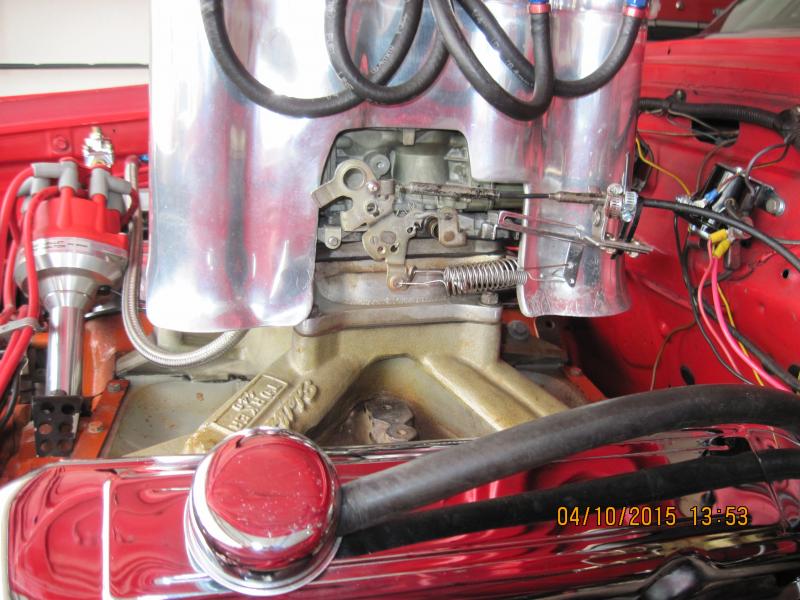

SORRY WRONG PHOTOS!.......I can't delete these?
