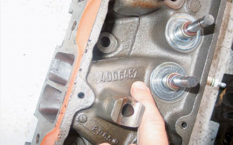

Big block heads are referred to by the last 3 numbers of their part number:
if you look at this example, this is referred to as a 452 head
