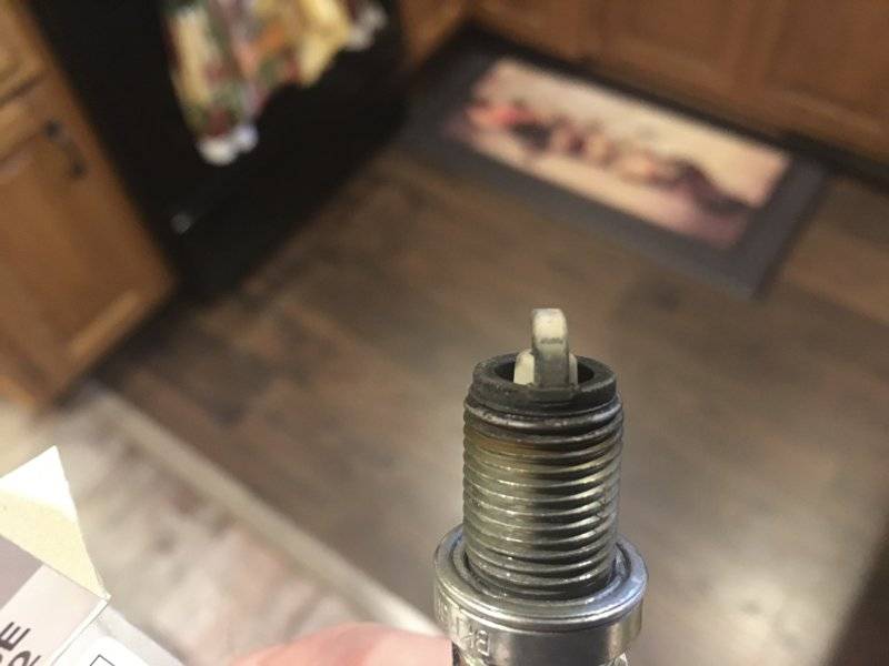

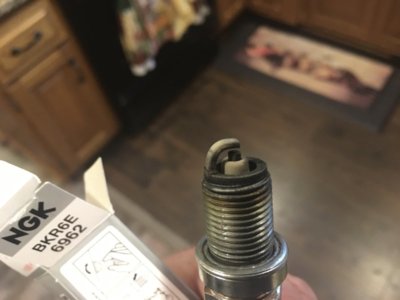

I'm useing the 452 heads also, with flat tops so there is no quench. I haven't had any spark knock but did experience some lean conditions which was creating higher temps. Reading my plugs, the timing mark on the plug straps told me I needed less timing. I also try to run E-free 90+ octane. Theres been occasions when I used 10% 93 octane and noticed the engine ran 5 to 10 degrees warmer. Performance is good with either. Reading your plugs can tell you just what you need for final tuning.
“Timing marks on plug straps”? Do tell or point me to information on that please! That’s new to me. Thanks!
Wow I had no clue. Will be popping out some plugs tonight.
If you don't have many miles on the engine, the results may not be conclusive but should give you a starting point. You want at least several hundred miles on plugs for a true reading

18 initial - 18 mechanical = 36 Total / Spark Plug Pictures posted
Currently before winter storage did some fine tuning
Running 15 initial - 18 mechanical = 33 Total
Zero pinging , ran awesome , will pull spark plugs in spring and compare
B9DFE8B6-B0DB-441E-BD1E-A6B136D97087.jpeg 550B1C55-3AC5-4451-8DDB-0421CE79B7A7.jpeg
