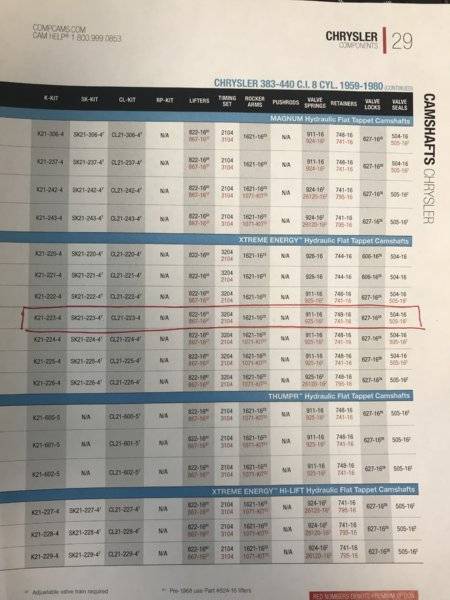

Lots of good info here, but of all the specs you listed, comp ratio would help, along with the exact cam your running. Lobe seperation angle and lift don't tell the story.
Just going to add that keep track of the rpms it pings at, and keep track of what rpm all your timing comes in at, I.E.does it ping in your timing curve or after it, or both.

Cool, good street cam. Like others have mentioned you should be able to get it under control with timing, and more simpler mods.
