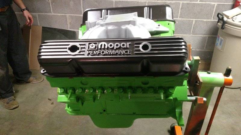

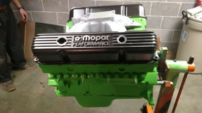

The dipstick goes into a place on the block just above the pan rail
You can see it better in this picture taken while we painted the engine
