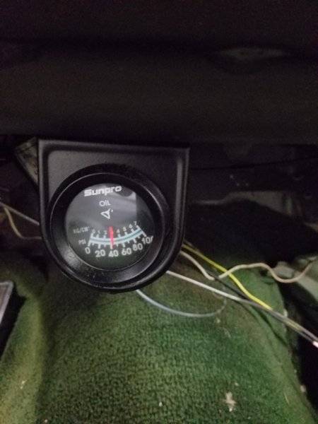

My mech gauge on 10w40 and amsoil brake in oil just after the same got worn in. It went up to 60 while driving higher rpm fresh rebuild on a 440 it was as low as 30 on the cold idle 20 on the warm idle after timing and adjustments etc.
My 440 runs @ 60 psi pressure all the time, at idle and while driving. (additional gauge says exact same)
Using 20W50 oil.
Using 20W50 oil.
Probably running a high volume oil pump i guess, engine was rebuild by PO so i am not sure what is in there.
