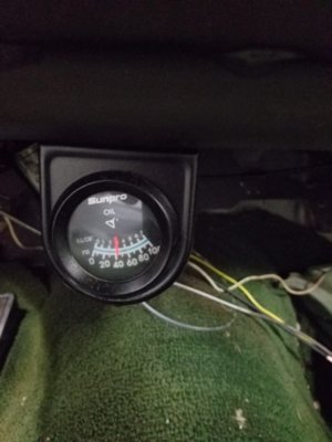

My 440 was rebuilt .030 over to stock specs except for a mild cam 30 years and 25,000 miles ago. (It was rebuilt by a previous owner.)
I unscrewed the oil sending unit and screwed in my shop gauge. I'm getting a tick over 50 PSI at cold idle, it drops to a tick over 20 PSI at hot idle. It's s tick over 40 PSI when the engine is hot and revved up.
Do I have anything to be concerned about?

Yep, nothing wrong with any of that.
If you really want peace of mind, do a full throttle high RPM run in all gears while watching the oil pressure gauge.
If the thing never drops to zero from starvation, call it good and enjoy. :-)
If you beat on it regularly at high rpm I'd shim the oil pump bypass spring. 10 psi/1000rpm. Cruising and the occasional romp it'll be fine like it is.

That shop gauge is in 10 PSI increments, a 'tick' means it's just over the line, for example, a 'tick' over 40 means it's just over the 40 line, probably about 42.
Revved up means about 3,000 RPM, I'm not drag racing this, I'm not doing 10,000 RPM burnouts...

About the width of gauge needle? Shimming a " tick " for pressure is just adding a 5/16" regular split lockwasher between pressure spring and plug cap(good for at least another 10#)

I suggest that you first put in a mechanical gauge that you can read going down the road. If your oil pressure is 40 at 4000 rpm, and 50 at 5000 rpm, in gear going down the road, you're fine. No need to shim anything.
