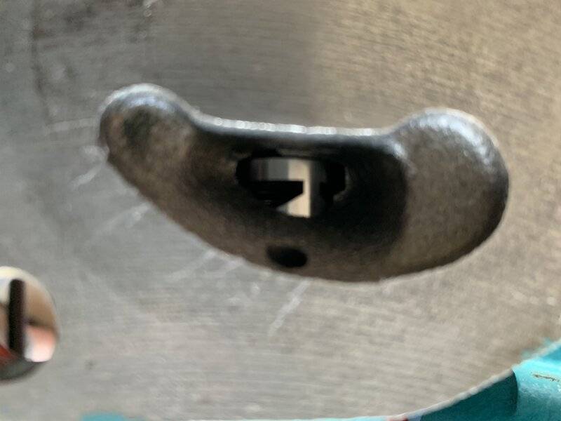

So the other day I was driving up the road to my parents house, gravel road going slow, and about 300 yards the oil pressure gauge suddenly went to 0, I didn’t shut it off immediately and continued until I got to the driveway and then shut it off. Motor was making all sorts of valve train clatter by then. I know there is a good chance I did further damage but it is what it is at this point.
So today I pulled the oil pump off to check it out. The relief valve doesn’t just slide out when you tip it on its side with the plug removed, should it? It comes out very easy though otherwise, but like I said it doesn’t just fall out.

I got the pump cleaned up and can definitely feel the relief valve hit when pushing it in and out with my finger. Here is a picture of where it hits and gets stuck. It’s not much and won’t take much to make it smooth but I don’t know enough about oil pumps to know if this would cause the issue or not?
