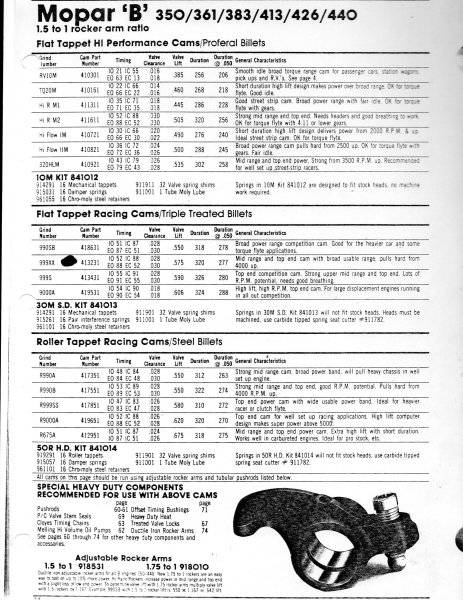

As you have already saw, you will get many, many opinions on what you should do. So here is mine and from my own experiences. I would definitely install higher compression pistons to work with the better breathing 452 heads because a 440 loves compression. Shoot for as close to 10:1 as possible and keep the 484 cam. I can promise you will have a strong running 440.
