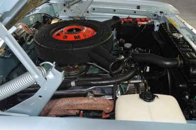

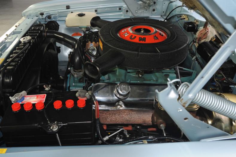

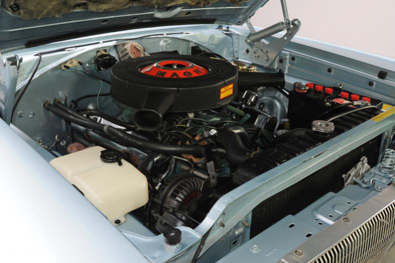

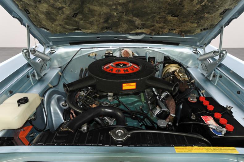

does anyone have a few pictures they can share with me on how best to route the plug wires on the drives side of a 440? I am running stock manifolds on a 67 Coronet R/T.
I don't have a pic but this might get you going. #7 runs along the inside of the valve cover (next to the intake ports) and the others go down along the front of the head and hook to the plugs from the bottom.
A few pics from 67 rt
