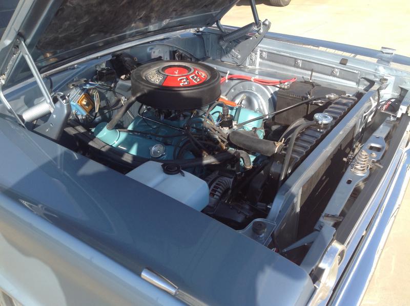

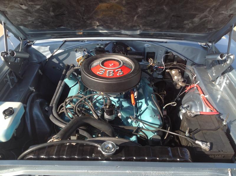

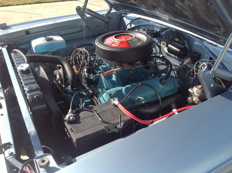

I used a 440 source engine front end kit on my last build:
http://store.440source.com/Engine-Front-End-Kits/products/16/
Everything worked great. They don't offer the kit with a single field alternator and won't break the kit up so I ended up with an extra two field wire alternator. Might be smarter to go ahead and upgrade to the newer alternator and voltage regulator in your 66. Here are a few not all that helpful pics of the 440 source parts in my 67. I was not intending to capture the pulleys and brackets in the picture so you can just barely see the tops. If you need better pictures that show the setup in more detail let me know and I can send you some. I know the air cleaner is wrong and the valve covers are wrong. If anyone has the right parts and doesn't want an arm and a leg let me know.
