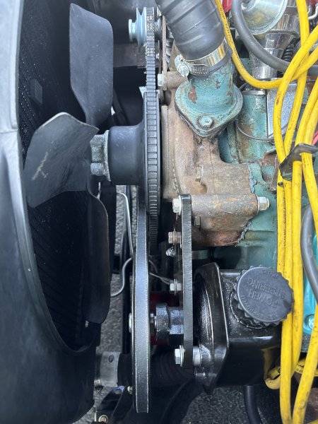

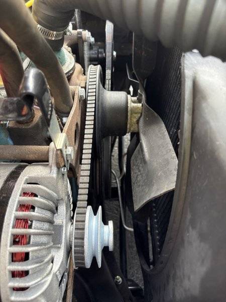

Both the alternator and power steering belts aren’t perfectly aligned with the water pump and damper pulleys. It seems the water pump is about a 1/16” off and about the same for the power steering. You can see the belt that was installed is starting to fray on the sides. The power steering pump is a new Bergenson. What options do I have to correct this?

BY THE WAY, YOU HAVE THE COOLING FAN INSTALLED BACKWARDS. THE SCOOP PART OF THE BLADES FACES THE RADIATOR CORE. THE FAN WILL MOVE AT LEAST 2X THE AIR WHEN INSTALLED CORRECTLY. you will likely need to add a 1/16" shim to the pump hub and/or pull the alternator sheave 1/16" further on the shaft. This misalignment is caused by not measuring first. FIX THE FAN INSTALLATION FIRST........just my opinion.....

And if the rear groove of the crank pulley matches well with the WP pulley.. then leave those alone and just adjust the alt and ps.
I'd prefer to have the proper single groove alt pulley myself,, but that can be made to work.

Yeah, that was done by the prior owner. I bought a new belt for the alternator and will now have to reverse that fan.

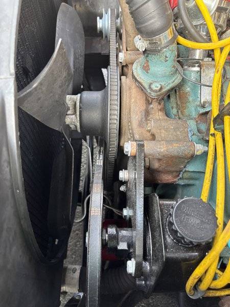

Power steering spacers are installed on wrong side of bracket.
I thought the same, but it I were to put in those spacers as you mentioned, its gonna push it further away from the damper pulley.
You can very easily change the alignment on the power steering pump pulley by taking it off the pump putting it in a press and pushing the hub one way or another. It takes very little pressure to move it.

Another example of "pulley hell".
Typically caused by mixing years and/or AC and non-AC parts.

Washers behind bracket at the pump might be an option for that.

That alternator I bought from either Autozone or Advance Auto. You think the single pulley would line up better?

I had to change the alternator and the power steering pump. It was a single pulley alternator, and I installed a Borgeson 800338 power steering pump. I really don't remember how well they lined up before as I was trying to solve the problems, and I've been told my fan is on backwards. So now I'm going to change that alternator belt, reverse the fan and hope to even up the alternator and power steering pump with the pulleys.

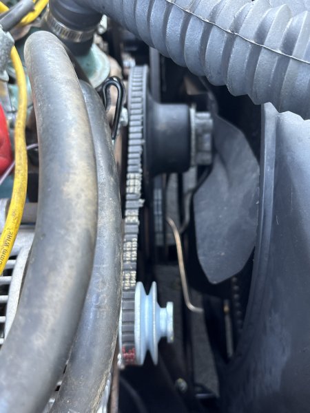

I spent the last few hours playing with the power steering pump and alternator pulleys. I was adviced to turn my fan around and I put some spacers between the pump and the bracket which moved the pump back, I think just enough. After turning the fan around, somehow the alternator pulley lined up pretty good. Now the pump belt is just about running the W/P pulley. Is that ok?
