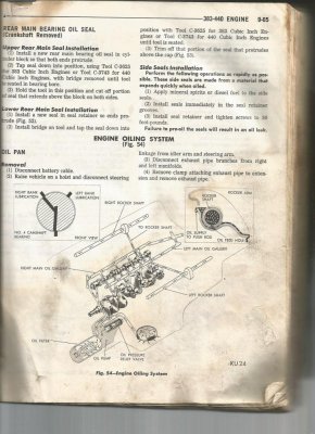

Wet wicking side seals. Soak them in carosine before installation expands the seal and makes a tight fit. Factory manual rear main seal installation covers this. Some instead of using the wick seal fill the seal cavity with silicone instead. I use the wick seals and also silicone the joint at block and rear main seal inside the block.

"Wet wick" refers to two little wicks that are supplied in the Felpro rear seal kit. The idea is you fill the cavity where the old style side seals would go with the supplied black RTV, then you insert a wick that was dampened with water into the freshly squeezed in RTV. This is to ensure the RTV cures perfectly as it is reliant on the absorption of moisture from the air...
Mineral spirits and diesel fuel also burn. Have used kerosene for years with no leakage problems.
