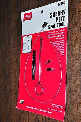

Should find one at Advanced auto parts or maybe NAPA
