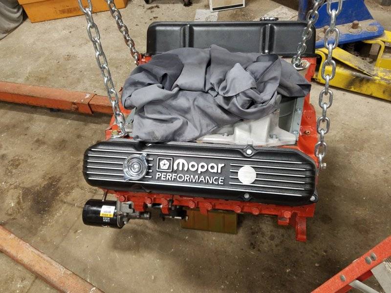

I just primed motor with this awesome tool that I should patent. :moparsmiley:
1.- When oil comes out your Rocker Assys, is that Sufficient?
2. - I'm about to install Valley Tray, Intake Manifold, and Valve Covers.
What sealant is best? Aviation? Black Stuff? Or a combination?
I use Hylomar except where the FSM may say to use something Else
I usually use anaerobic gasket maker instead of silicone- which is way overused on many motors I tear down
More ?s
Roll the motor over by hand a 1/4 turn at a time to make sure oil gets everywhere.

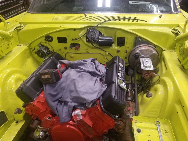

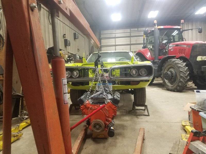

I was going to mention that 4+ is kind of hard to find....but wal-mart has it.
Cranky beat me to it.
"Like a Glove"
^^^^sweet!^^^^
