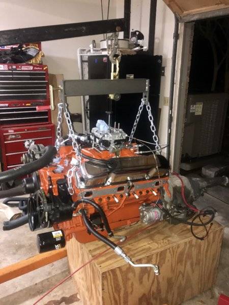

440 sits 1/2” highter on driver side

Just put the motor in last week and noticed the driver valve cover is 1/2” higher than the other. The mounts are down and the bolts are in the center of the holes in the feet and in the welded nuts. Ideas? Trans is flat on the mount too. Tried lifting just the passenger side but the engine comes up level.
My mounts
Either the rubber insulators are not the same thickness or the metal brackets are not the same length. Got pics of it sitting on the k frame?
