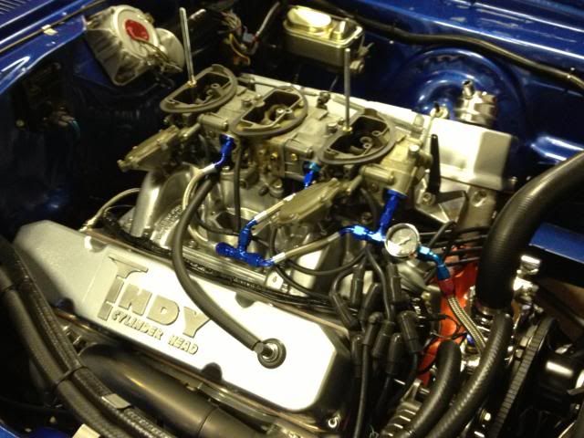

440 six pack set up
This was right when I had got the carbs back from Promax. Unfortunately, I didn't flush the stainless steel braided fuel lines I bought from them, and I found out over the next few days that I had braid clippings or "shards" stuck in some of the primary well emulsion channel fittings. That was at my ONE "big event" of the year, Cruisin the Coast. I was pretty pissed because my car ran like **** and I had just spent a lot of money to have the 6bbl modded and tuned by Promax, but because I was rushed, I neglected to flush those new lines. I had that little nagging guy on my shoulder telling me to flush those lines out too!
As soon as I took the carbs apart, flushed them out under pressure, and thanks to the non stick reusable gaskets put it all back together, it ran GREAT with NO ADJUSTMENTS.
