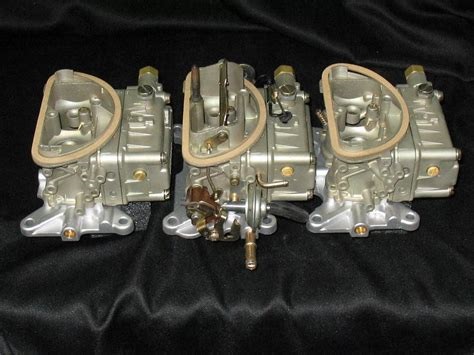

Almost all I know about six packs is book learning. I remember car magazines back in the day talking about mechanical linkage on six pack cars. It was said that they work just fine for drag racing as one was coming off the line with enough RPMs to avoid bog. on the street was a different story.
Question part: I saw a six pack set up that had accelerator pumps on all three carbs. It seems like that would eliminate bog. I don't know enough to know.
I ran two of the mechanical setups with all 3 accelerator pumps. Very nice setup with great response and super easy to tune. 3.23 gears, 4 speed on one of the setups and it had awesome response.
I've always been a Mopar mega fan, but I've never heard of this. In the 70s you could buy a six pack that had been converted to mechanicals for 300 bucks. Some guys who didn't like mechanicals would trade straight up for a good working four barrel set up.
The “triple pumper” 6-pack setup has side hung float bowls (not “V” bowls) and fuel enters on driver’s side instead of passenger side. Trans-Adapt (?) or some other aftermarket company sold the linkage (I used to have one). I never ran the triple-pumper, but I’m sure there’s no bog, but gas mileage must be HORRIBLE
I ran one many years ago with a 4 speed. It didn't bog but it wasn't fast either. Running on just the center carb with the outers disconnected was much faster up tp about 3700 rpm.

How do you have enough room for the metering block on the rear carb? I like the stock diagram set up. Really don't care for the GM set up.
The side hung float bowls have way more clearance. The tight fit is the rear carb to center carb clearance. I think they’re Ford bowls if I recall. All 3 carbs have metering blocks & accelerator pumps. The mechanical linkage I had was progressive I think (many years ago)
I used the factory "Direct Connection" setup modifications with lighter secondary springs with great results. Later, with my new 493 stroker, I had it dyno tuned at Steve Morris' shop, I assisted and we went richer 10 jet sizes on the secondary carbs to reach max power. The carbs worked the same at either jet size but, that extra fuel really helped the dyno number. Is your ignition advance optimized for your combination?
Mike
factory Six Packs only had the accelerator pump on the center carb, so they could bog on the street from idle. Drag strip launches hid it with higher RPM.
Adding pumps to the outboards pretty much eliminates the hesitation and makes it drive way better daily. Lot of guys do it.....works great if you’re not chasing 100% stock points
I tuned that out and higher stall converters and steep rear gears help too. The Mopar "bibles" had setups for the Six Pack engine.
Mike
I run a mechanical setup on my 512. Goes high 10’s through the mufflers. Took some work to make them happy on the big cube engine. I’ve ran the vacuum carbs on it as well. I prefer the pumpers on this combo.
