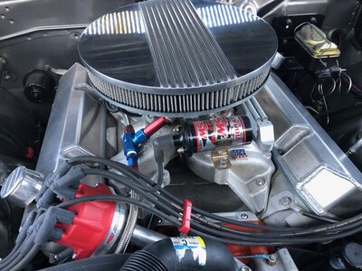

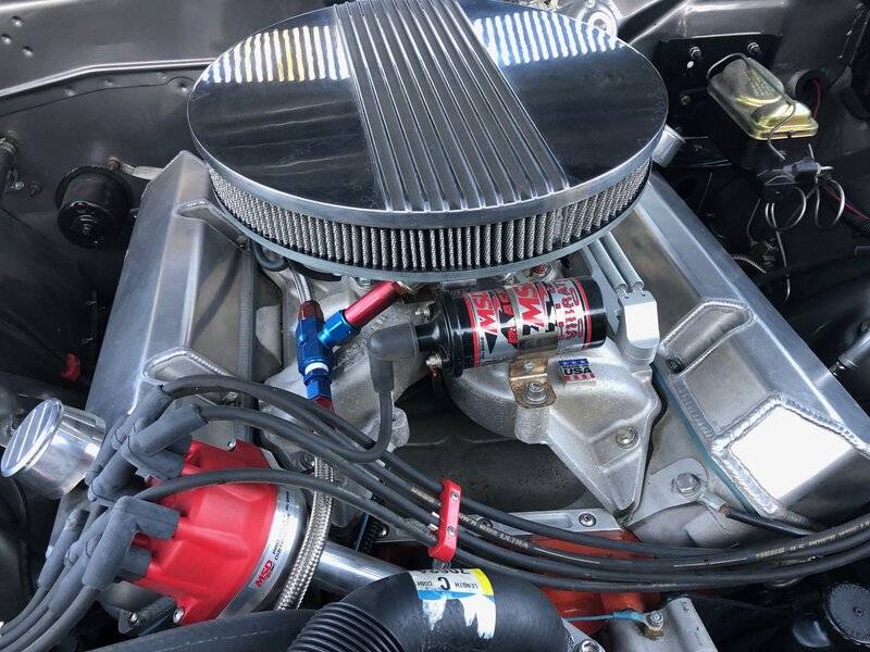

The 512 in my Challenger has been great. Its got the stealth heads but, it has all Lunati valve springs and retainers. in them and, a Lunati hydraulic roller cam in it. If i build another big block it will be one of these.
