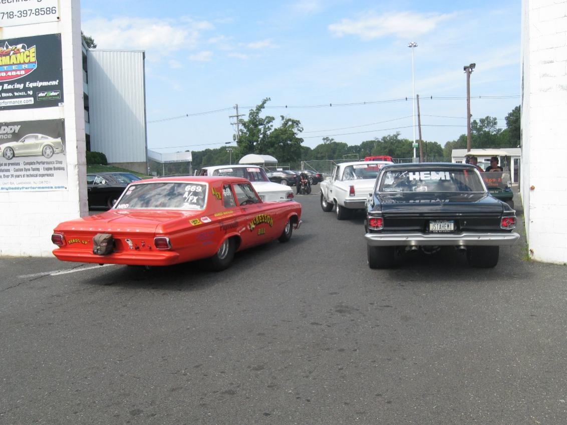

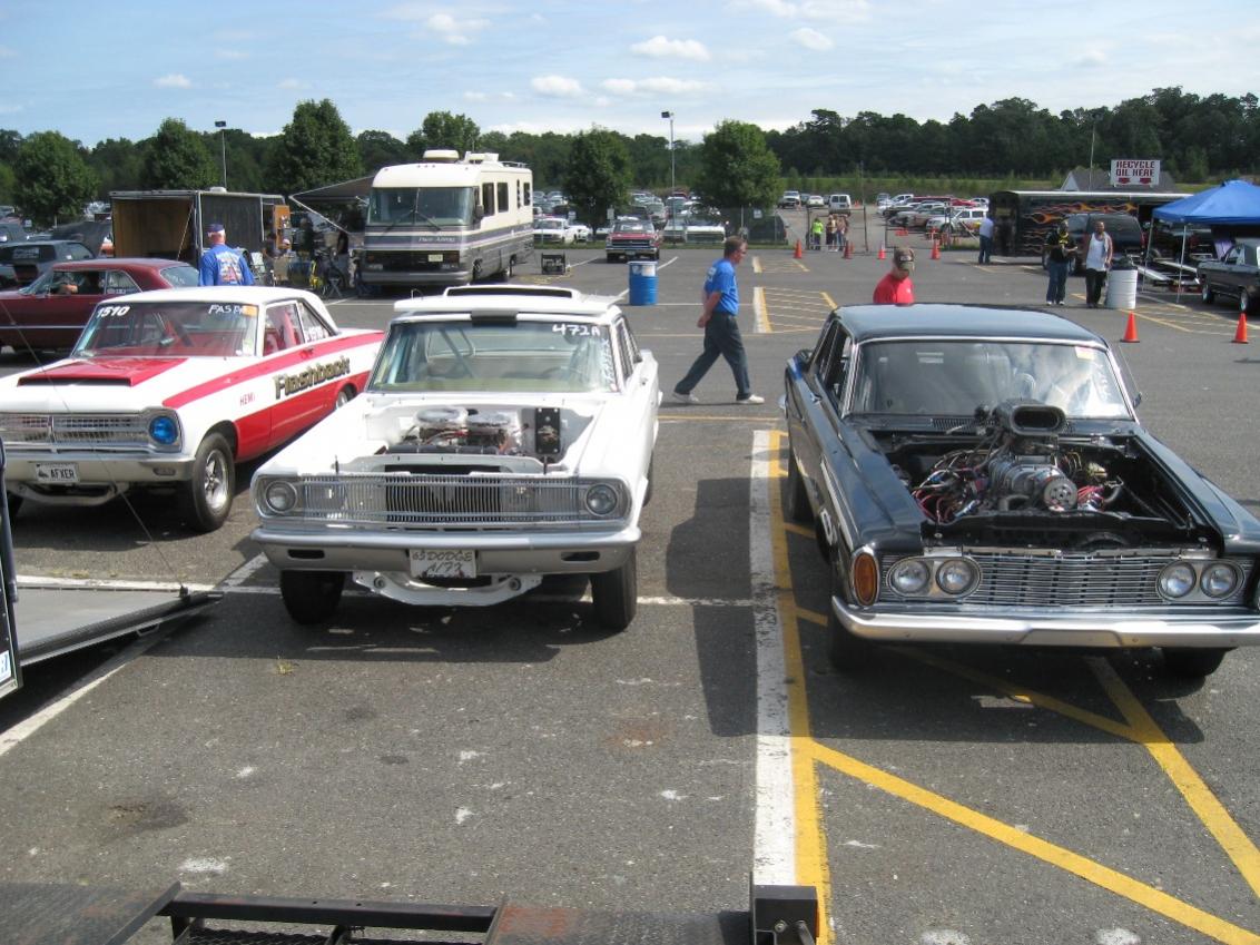

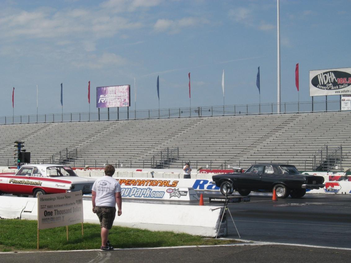

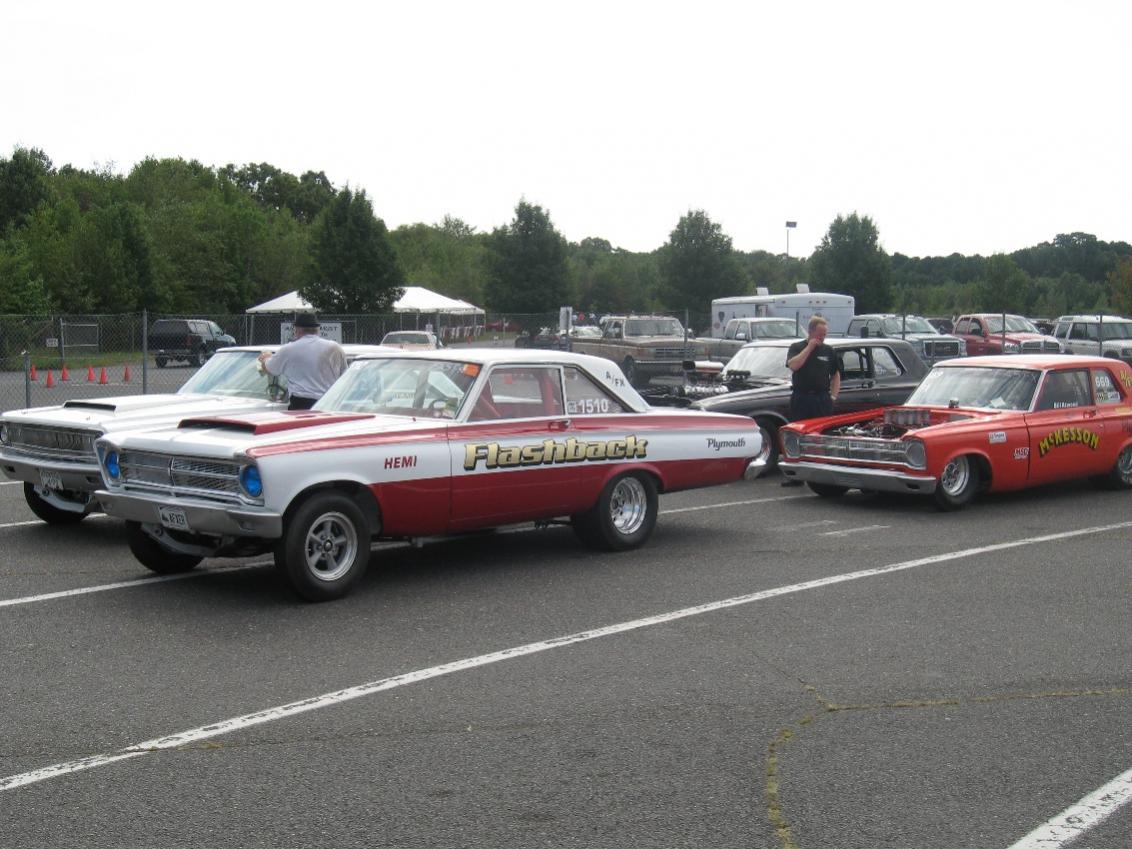

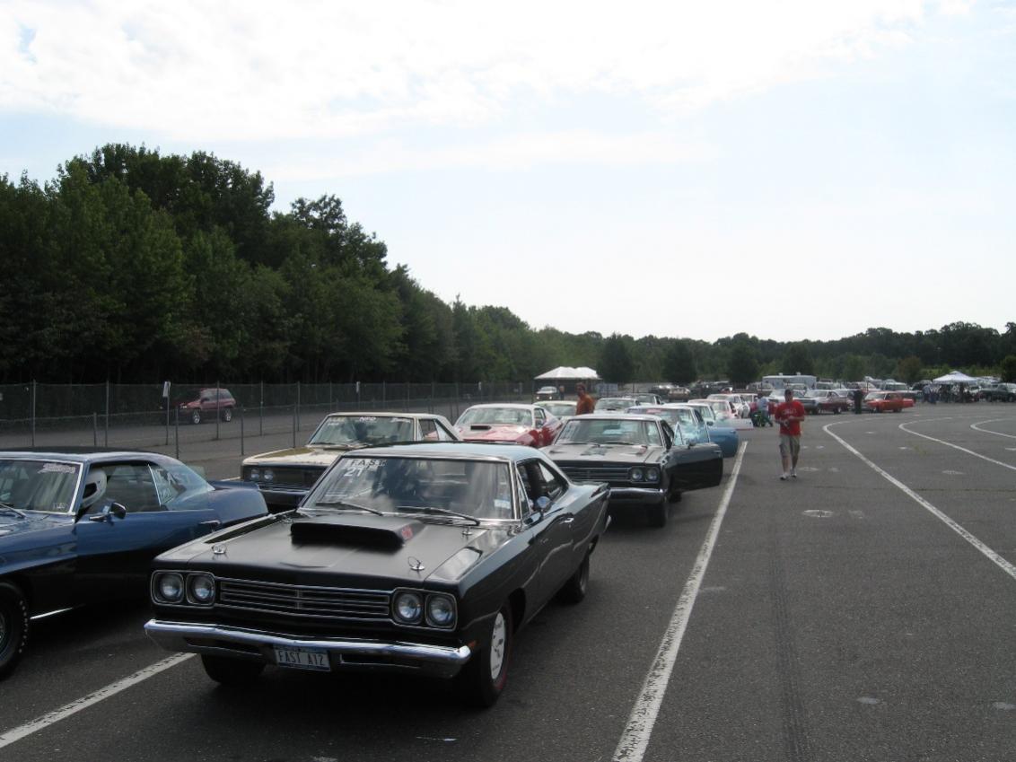

The source stuff seems to be betting better,,,,,,,,,,,but,you need a really good engine builder to carefully check every componant for square & true.I have heard stories of cranks needing alot of attention before it could be used,rod having to be reconned even though they are new.Overall their kits seem to have many happy customers.As far as your build,without having budget constraints I would consider a good 440 block as a better foundation for an easy 500 cubes.There are NO LIMITS to internal mods,so it is easy to get carried away.I will also say that I have played with the SUPERCAR guys and they are a GREAT bunch of guys.I end up in the AFX class.You don't have to have the fastest car there to have a blast.Do you have an engine builder??
When I die, I hope heaven looks like that and they are all mine. Of course I could draw the short straw and hell would be imports, ford escorts, and an occasional Pacer.
