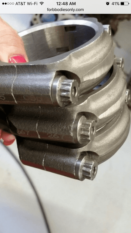

Plan to have new fasteners put in and resized. The ones they come with are garbage. I used the same set in my six pack motor. I should have just stroked it to begin with. Hindsight.

Thanks for the tip and pic. Ill have those replaced with ARP. Funny they mention how superior their rod bolts are in the listing on the site. Is that a chevelle in your garage?
Sorry for the chevelle it was pulled in just to charge the battery. Hideous thing.
I know they rant and rave about the rod bolts I'll find my old post with a picture of my machinist holding one
I also had to have them resized.
In 440source defense they offered to take them back
I was going to say - Source rods...ALL Source rods are a mess. Because they are final machined with the wrong lube on the threads of the bolts. Cycle the rods a few times with the supplied ARP lube and the big ends go out of shape. I always include a redo of the rods and honing the pin bores when I qoute Source rods.
