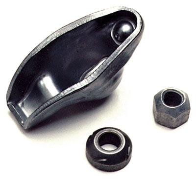

Lifters, rockers all stock. I did replace one rocker before I installed motor in car (due to hairline crack). I bought 2 as a set. I just pulled the other of the wall in my shop, and I noticed there is no small oiling hole at lifter. Shouldn't they all have that?
Just thinking...

In the pushrod seat, I assume.
Isn't that a GM rocker?
440 has shaft mounted rockers, and oils through the rocker shaft. Did you install the rocker shaft with the holes pointed in the correct direction "not upside down"?
Yep, I couldn't find a picture of a Mopar rocker. My bad. I was thinking the pushrod seat would have a hole in it for oiling from the top, but it's been awhile since my last day of sobriety.....
