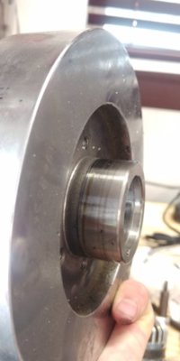

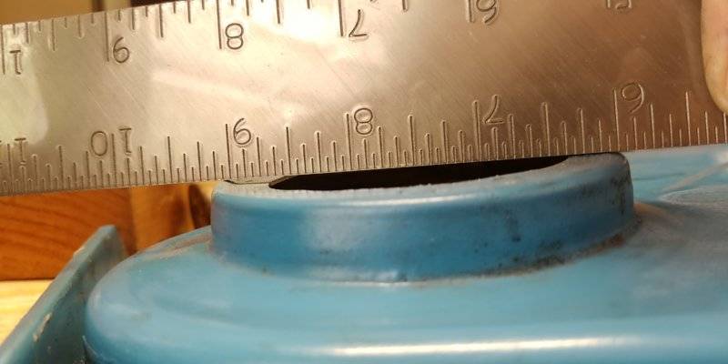

I got the seal out. Noticed that the lip for the seal has an indentation as if when they installed the harm balancer years ago it pressed it in. Should this be a cause for concern? It's not much, and i didnt notice a leak before from there..

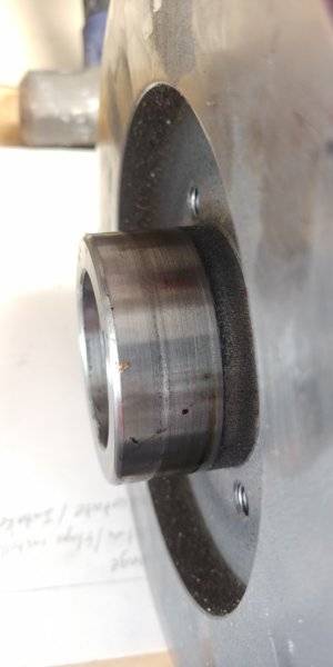

How does your balancer look where the seal rides? Deep groove, shallow groove? Pics?
It looks like a newer balancer. I think you can sand it a bit, try and create crosshatch pattern like honing a cylinder.

When i run my finger across the surface of the harm balancer, it's perfectly smooth. I don't feel any indentations.
